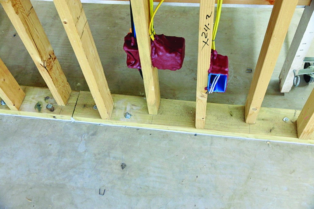

Staggered studs. This is a common method of building a quiet wall. We use 2x6 top and bottom plates, and then fill in the studs with 2x4s on a 16-inch-on-center layout, offsetting the layout by 8 inches. You essentially get most of the benefits of two walls, but it is a lot easier to build. When sound hits one side of this double wall and starts vibrating the drywall and 2x4s, that vibration does not transfer to the other side. Sound can transfer only at the plates, an area that’s not very significant compared with the entire surface area of the wall.

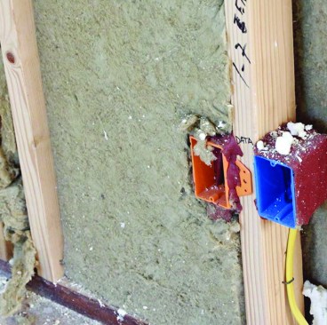

Sealing electrical boxes. With codes typically requiring outlets every 6 feet, it’s hard to have a bedroom wall without an outlet. But electrical boxes have a lot of holes in them for all the wires to poke through. You also end up with a hole in the drywall around the outlet. All those holes need to be sealed to prevent sound from freely passing through them.

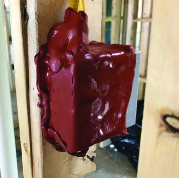

For sealing outlet boxes, we use putty pads. These are made for fire stopping in commercial applications, but they work well for soundproofing electrical outlets. I like the thick red pads from Hilti (CP 617) the best. We get them at commercial supply houses or the Hilti store; they are much better than the thin ones sold at big box stores. The Hilti pads are 6 inches by 7 inches; we center them over the back of the boxes and fold the edges over the sides of the box. The material has a consistency like Silly Putty and effectively shuts down the air flowing through all those holes that might otherwise carry sound.

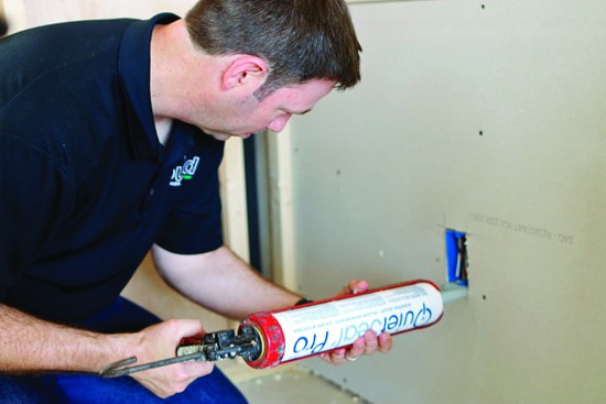

Once the drywall has been installed, you also have to go back and use an acoustical sealant to seal between the drywall and the box to complete the installation. We have had good luck with the Noiseproofing Sealant in St. Gobain’s Green Glue line or QuietSeal Pro, which is part of the QuietRock line. Acoustical sealant stays flexible; it won’t set up and get hard. This flexible seal not only stops airflow, but it also isolates the electrical box from sound vibration coming through the drywall.

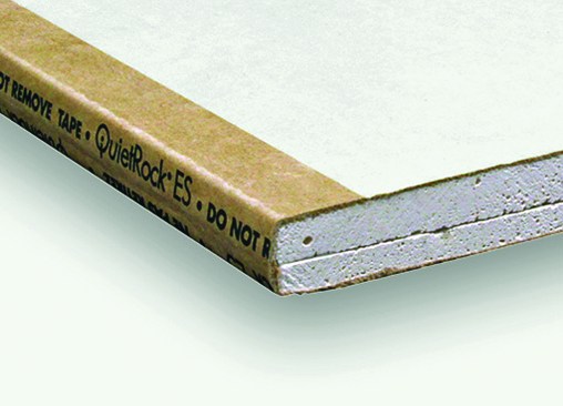

I have also used QuietRock (quietrock.com) effectively. This system essentially uses double sheets that have been pre-bonded together, so you cut down on the installation time. Each sheet is installed with acoustical sealant around the perimeter, so it’s not as fast as installing one layer of conventional drywall, but it’s faster than bonding two layers with Green Glue.
