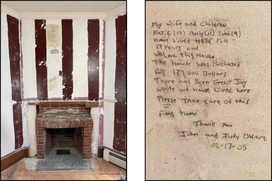

So while removing wallpaper in an 1882 Queen Anne–style home, we were excited—though not surprised—to uncover a heartfelt note on the plaster wall beneath, written by a previous owner in 2005 (above left). The note expressed an immense love for the old home and pleaded with future owners to love and care for it as the writer had. Because he also listed the names and ages of his three children, I did a quick search of social media and discovered that I had several friends in common with the oldest daughter. I sent a picture of the note in a private message and let her know that we were updating the home with the care and love her father had hoped for (above right).
She responded within minutes, expressing her gratitude and joy, and asked if there was any way that this artifact could be preserved. I felt in my bones that I needed to try to make this happen for her, and while I wasn’t sure how, I was pretty sure I knew of an expert in old homes who could help me with this delicate undertaking: my boss, Warren O’Shea of O’Shea Builders.

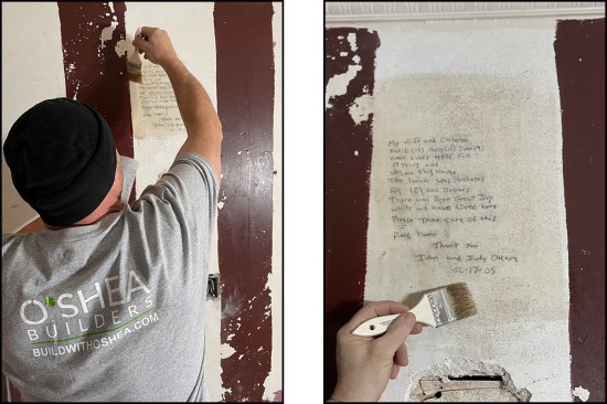

Once we had honed our technique, we sprayed the area with the note with three coats of artist fixative spray. This would prevent smudging of the pencil graphite when we brushed on the two-part epoxy coating after the fixative had dried (above left, right).

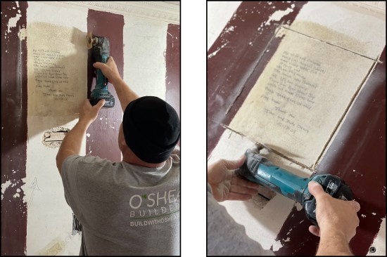

After the epoxy cured, then gingerly made shallow, 1/16-inch-deep passes on either side of the note (above left). We worked deliberately, alternating sides with each pass, until we reached the lath. Next, we used the same approach to make our horizontal cuts at the top and bottom in the gaps between the pieces of lath (above right).

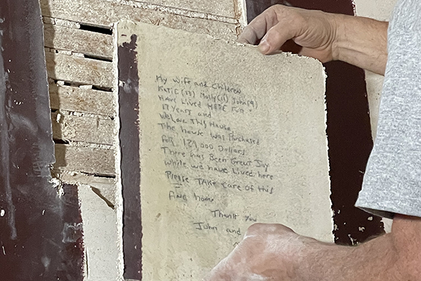

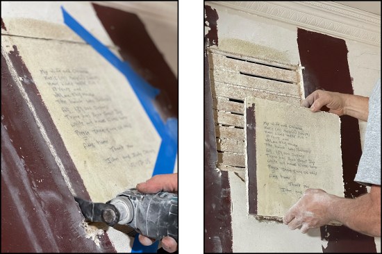

Before carefully cutting through the lath, we applied plenty of tape to the area to prevent the plaster from falling away and onto the floor (above left). The vibrations from the multi-tool helped by knocking away the plaster keys, leaving the memento intact (above right).

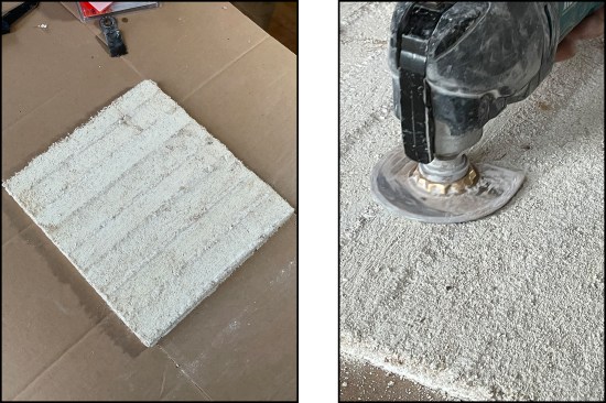

Finally, using a piece of cardboard as a backing to carefully rotate the plaster section horizontally (above left), we carried it to a table where we used the multi-tool to smooth out the back (above right).

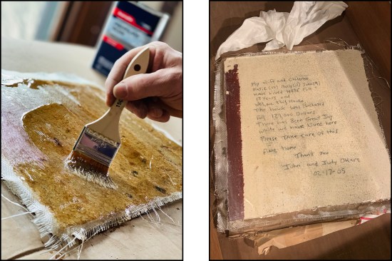

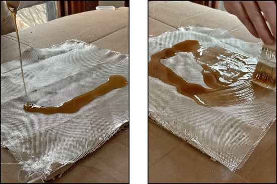

Then we cut out an oversized piece of fiberglass cloth, placed it on the back of the plaster, and painted on two-part epoxy to saturate the cloth (above left, right).
A paint brush was used to work the gel coat into the cloth onto the plaster surface. We applied a thick coat of the epoxy to compensate for the uneven surface of the plaster, using all the gel coat we had mixed up, then spread the gel coat out to the overcut edges of the cloth (above left). After letting the epoxy dry overnight, we flipped the plaster memento over (above right) and later cleaned up the edges, using a wood frame to make sure the sides were cropped evenly.
