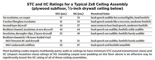

If the budget allows, use decoupler clips instead of resilient channel. Though less widely available and considerably more expensive than channel, decoupler clips will give the ceiling assembly a higher STC (sound transmission class) and IIC (impact insulation class) rating (see chart, below). Most of the time we use standard RSIC-1 clips (866/774-2100, pac-intl.com) or, if the ceiling needs to be leveled, RSIC-DC04 or RSIC-EXT04 clips. A 10-foot by 12-foot room would require about 40 clips, which cost between $4.50 and $6.50 per clip.
Most building codes require multifamily party walls or ceilings to have minimum STC (sound transmission class) and IIC (impact insulation class) ratings of 50. Installing carpet over padding on the floor above is an effective way to significantly boost the IIC rating of all of these ceiling assemblies.
To combat airborne noise, you should also add mass to the ceiling assembly. The standard approach is to add a second layer of drywall, but I suggest a layer of 1/8-inch-thick mass-loaded vinyl instead. Sandwiching 1-pound-per-square-foot mass-loaded vinyl between the resilient channels (or decoupler clips) and new drywall will improve the ceiling’s STC rating even more than adding two extra layers of 1/2-inch drywall would. It will also contribute further resiliency to the assembly to help muffle structure-borne noise. One-pound-per-square-foot mass-loaded vinyl sells for about $2 a square foot. If you’re dealing with low-frequency noise, such as amplified sound from a stereo system, you could install heavier 2-pound mass-loaded vinyl, but it would be much easier to add this material to the floor above.
