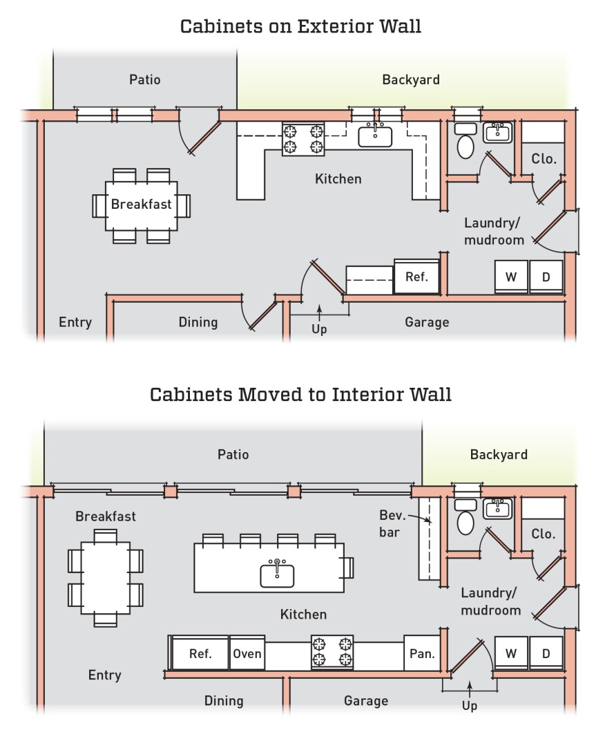

Design Guidelines for Connecting to the Backyard
  • Depending on the layout, consider moving the perimeter kitchen cabinets to an interior wall: By flipping the kitchen, the exterior wall can now contain sliding doors or large windows allowing backyard access or sunlight directly to the island seating area. This layout is also perfect for a sink in the island, since clients can look outside while using it, as they did in the good old days with a kitchen window above the sink.
  • Include lots of windows to the backyard. If the perimeter cabinets are on the outside wall, first design the back wall with the maximum number of windows. Using smart island and pantry design, plan for the rest of the cabinetry to store everything that would traditionally be in those perimeter upper cabinets.
Click to enlarge
Depending on the layout, consider moving the perimeter kitchen cabinets to an interior wall: By flipping the kitchen, the exterior wall can now be sliding doors or large windows, allowing backyard access or sunlight directly to the island seating area. This layout also provides a perfect opportunity for a sink in the island; owners can look outside while using it, just like the good old days of watching out the kitchen window.

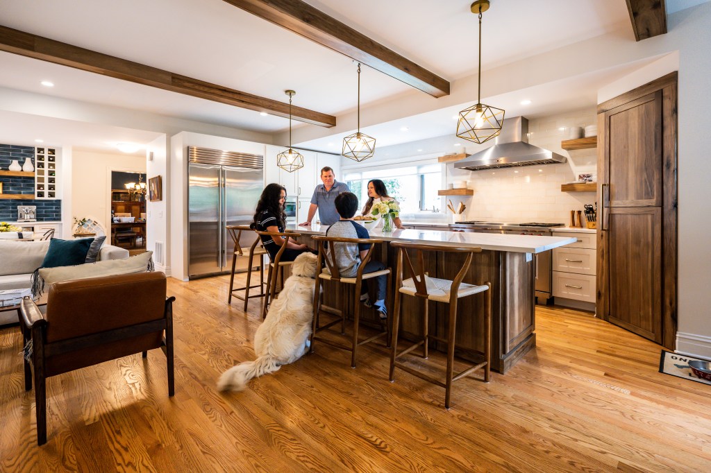

This kitchen demonstrates the trend toward having few upper cabinets in lieu of more windows and ample wall space. While white-on-white is in decline, white is used here to contrast with a darker island.
Matt Adema/LivCo
