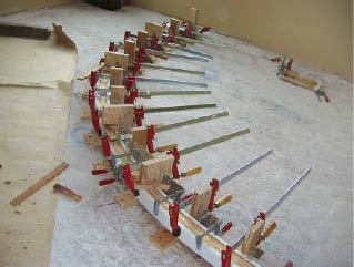

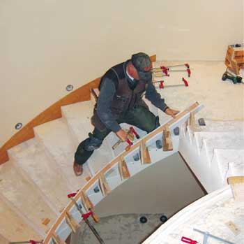

Bending guide. In order to have something to clamp to, I screwed L-shaped bending guides to each tread. I made the guides from 1 1/8-inch plywood with 3/4-inch OSB gussets; they needed to be rugged because they hung over the edge of the staircase and would be subject to considerable stress. We used similar guides to bend the balcony rail, but since we were bending it on the flat there was no need to bend it around the balcony framing. Instead, we scribed the arc on the floor of a nearby room, screwed the guides to the line, and laminated the rail there.
In preparation for making the spiral handrail, the author screws bending guides to the rough stair.

Accounting for springback. To accommodate the springback that occurs when curved laminations are removed from the form, I positioned the guides to overbend the curve slightly. I did this by installing the first guide on layout halfway up the stairs. On each successive step — up and down — I pushed the guide 1/16 inch further out from the edge of the stair, for a total overbend of about 3/8 inch at each end. The rail sprang back a little more than expected, but not enough to cause a problem (see “Calculating Springback,” page 5).
When you don’t use continuous backing, as in this case, a bent lamination will tend to flatten out between the last two clamping points. To prevent fitting problems, I ran the rail long and provided an extra bending guide at the top and bottom. This allowed enough extra length that I could cut off the flat spots and still have a long enough piece.
Twisting the rail. When bending rail is used to create a spiral, the railing needs to be twisted inward slightly as it spirals up the stairs. This requires a lot of downward pressure, so we provided clamping points by screwing short lengths of 2-inch plastic electrical conduit to the rough treads. The end of an F-clamp fits nicely into the pipe, and you can clamp pretty hard against it provided it’s fastened with long washer-head screws. Plastic plumbing pipe won’t work because it’s too brittle.

Before gluing, we sealed the MDF molds with lacquer and a coat of wax to keep them from sticking to the work. Then, working on a nearby bench, we placed a side ply in one of the molds, spread glue on it, stacked the next piece on top, spread more glue, and so on until all the pieces were glued and stacked between the molds. I secured the bundles every few feet with plastic stretch wrap to keep them together while we moved them into place and clamped them to the guides.
Clamping. With bending rail, I have a simple formula for how many clamps to use: every one you’ve got (see “Homemade Bending-Rail Clamps”.
We used one clamp per guide and two smaller clamps between guides, starting in the middle and working toward the ends one guide at a time. You don’t want to clamp too far ahead, or you could capture a wrinkle and create a gap between laminations.
The rail gets clamped to the guides while the glue is wet, starting at the center and working toward the ends.
The process takes a lot of clamps, for both squeezing the plies together and bending the assembly to the curve.
The balcony rail is bent in a similar manner, with wood wedges providing downward pressure.
