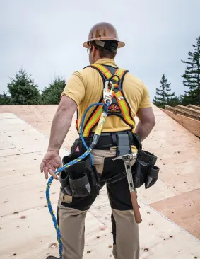

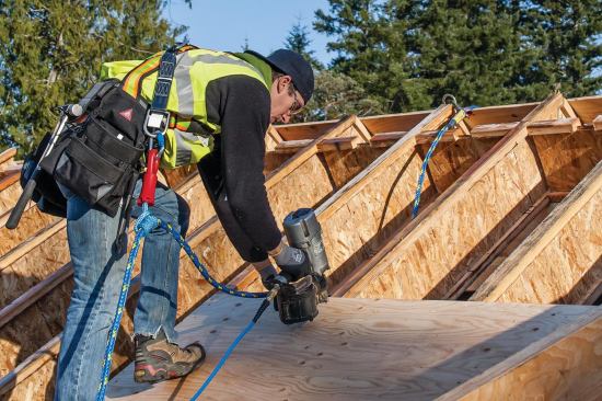

Harness. Often, the most simple and cost-effective way to work safely high above the ground is to wear a harness that is securely attached to a safety line. Even if you’re a sole proprietor and are not subject to OSHA rules, a harness is a good insurance policy that you can carry around in your truck. Molloy supplies his workers with DBI/Sala’s Compliance-in-a-Can (dbi-sala-safety.com), a $120 kit that includes 50 feet of 5/8-inch lifeline with a snap hook and a reusable roof anchor bracket along with the full-body harness.
Most basic harnesses have a single back-mounted D-ring, but the union roofer I spoke with prefers a harness equipped with multiple D-rings. For certain tasks, he says, he uses the rope to hold himself in place on the roof as he works, and it’s hard to do that with a back-mounted D-ring.
Sometimes a worker wants a harness that has different features or a better fit than the model offered by his company. In such cases, many employers — including Molloy — will pay part of the cost of the upgrade. According to the union roofer, you’ll quickly appreciate the difference between a $75 harness and a $300 harness if you ever do fall off a roof. But if you need only occasional fall protection, you may prefer a basic harness, which will weigh less and fit better under a toolbelt.

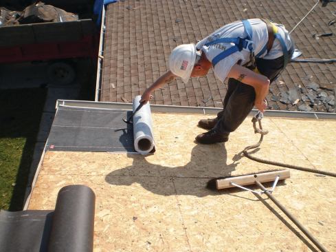

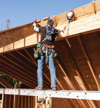

Anchors. OSHA rules require that a single-attachment-point anchor be strong enough to support a 5,000-pound load in any direction. On a reroofing job, that means that temporary anchors can’t be attached to just the sheathing, but need to be nailed through the sheathing into framing.
Permanent anchors — some of which can support multiple workers — are also available and would appear to be a sensible safety upgrade, especially in new construction where the framing is exposed and the strength of the connection can be verified. But installing permanent anchors raises questions of liability. For instance, who’s responsible for maintaining and inspecting the anchors — the building owner, the GC, or the sub who installed them?

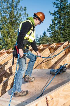

Finding a good anchoring point can be tricky. When installing roof trusses, for example, you can’t just attach an anchor to the first truss and then use a rope-and-harness system to install the remaining trusses. A single truss isn’t designed to handle out-of-plane loads — the kind of load that might occur when a worker who is wearing a harness that is attached to the truss falls — without bracing and sheathing. Studies have shown that lateral loads created by the falling worker can either fracture the bottom truss chord or cause the metal truss-wall connectors to fail. In either case, the truss could collapse or break away from the structure.
There are ways to avoid this problem. For example, anchors can be attached to truss sections (typically four trusses) that have been assembled and sheathed on the ground, then lifted into place with a crane. Another option is to attach the safety line to an engineered spreader that distributes the force of the fall-arrest system across several braced (but still unsheathed) trusses. Of course, many builders choose to install trusses while working from scaffolding or ladders, limiting the need for harnesses altogether.

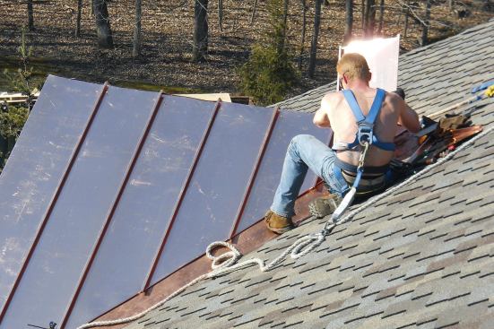

Safety line. The weak point in most fall-arrest systems is the connection between the harness and the anchor point — not because the connection isn’t strong enough, but because many workers “forget” to tie off or clip in. According to Molloy, this is the most common safety violation and the one most likely to trigger an inspection during an OSHA drive-by. Like anchors, safety lines must have a breaking strength of 5,000 pounds; many are also equipped with some sort of shock absorber or deceleration device and quick-release harness safety clips.
Another common violation in roofing work is using a safety line that is too long. It doesn’t do much good to be tied off to a rope that won’t stop you before you hit the ground.
To avoid this problem, safety lines are typically attached to harnesses with a lanyard equipped with a rope grab, which allows workers to easily adjust the attachment point. Most rope grabs are mechanical devices; some are operated manually and some work automatically, like a clutch. They allow free movement as long as the worker is moving slowly, but grab automatically during a fall or sudden movement.

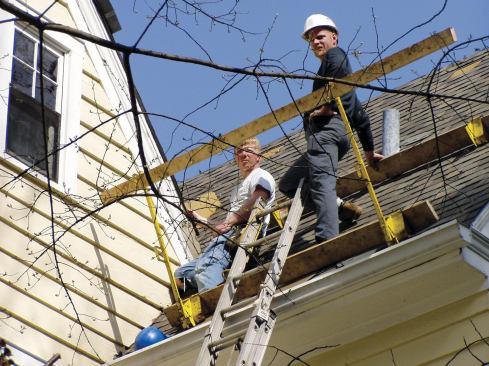

Guardrails. Roof jacks can be used on roof pitches between 4:12 and 8:12, but harnesses are also needed unless the roof jacks have integral guardrails. Safety harnesses are required on roof pitches steeper than 8:12. Remember too that workers within 6 feet of a rake edge need fall protection. Rake edge guards are available to meet this requirement, but technically you’ll still need to be roped off to install them.
Guardrail systems are a reasonable option for flashing repairs and similar work where movement is limited. But roofers work fast, installing 10 or more squares of shingles per man per day on some roofs. As the union roofer I spoke with noted, a contractor couldn’t afford to buy all of the guard-equipped roof jacks that a commercial crew would need — much less spare the time to install them and move them around.

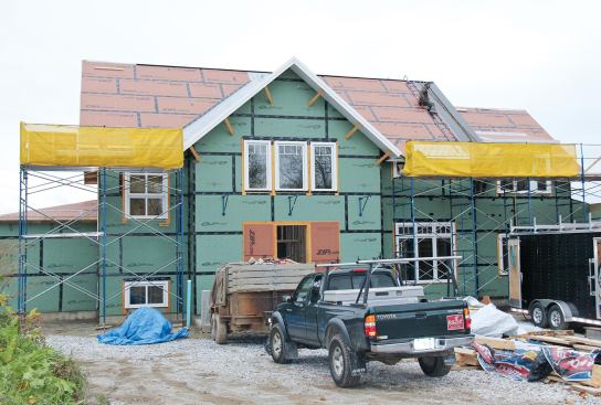

Scaffolding. On one job site I visited recently, the GC (who was also the roofing contractor) used pipe staging to build a continuous work platform underneath the eaves. The top sections of the scaffolding were fully planked, and his crew installed guardrails around the perimeter of the work platform. A similar OSHA-compliant work area could also be assembled with exterior bracket scaffolds, which bolt through the wall framing.
This approach brings the roof eaves down to ground level in OSHA’s eyes and — except for work along the rake —eliminates the need for safety lines and harnesses. The investment in staging sections and planks is significant, of course, but for a builder who is also trimming windows and eaves and installing siding, the increase in productivity may be worth the cost.
