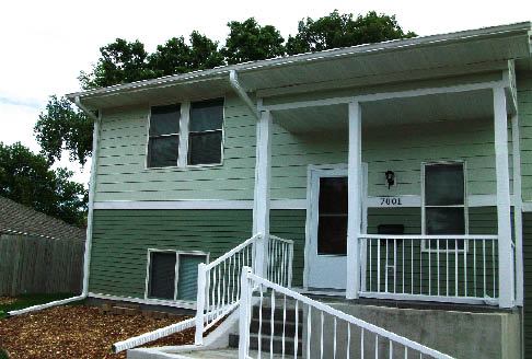

Gutter Assembly
While the gutter is on the ground, I crimp on the end caps using my snap-lock punch. I use plenty of sealant as I go, making sure every joint is watertight. (Driving around town sealing up leaky gutters is not a profitable way to spend a day, especially given today’s gas prices.) I don’t use regular caulking or silicon — they don’t work! Spend the extra two dollars on a proper sealant. I use 12-1 Seam Sealer from Ruscoe (330/253-8148, ruscoe.com). It flows better than caulk and oozes into the gaps.
I use a hole punch to make the outlet holes, which I do on the ground when possible. The punch leaves a nice clean hole for the drop outlet tube that the first elbow attaches to. You can also easily use the punch after the gutter is installed, which allows you to place the hole exactly where you want it in reference to the house. My punch is an older model that only makes holes. For around $200, Malco (800/328-3530, malcoproducts.com) offers a punch that can either make a clean hole for an outlet tube or be set to leave tabs for attaching the elbow directly — meaning you don’t need the drop outlet.
If you don’t have a punch, you can also make the holes by hand: Mark the location, using the drop outlet as a template; drill out the corners with a core bit; and finish the cut with snips.
Hangers and Aprons
Before installing the flashing apron or the permanent hangers, you need to make sure the gutter is exactly where you want it. So I generally start out by fastening the gutter through the back using just screws. If the fascia is in good shape, zip screws are often good enough for this first step. Once the gutter is attached to the fascia, I check to see that it’s centered properly. It should run about 1/2 inch past the ends of the shingles. When it’s centered, I check to see that it slopes toward the outlets. I don’t follow a prescribed percentage of slope; the idea is to avoid areas where water can pool. (In this part of the country, pooling water means more mosquitoes.)
I consider gutters to be an architectural element, so I always try to slope them as little as possible while following the lines of the fascia. A gutter that slopes too drastically will make the fascia look crooked. As mentioned above, on older homes it’s not always possible to follow the fascia lines; it’s more important to ensure that the water will flow to the outlets.
Once I’m satisfied with the gutter placement, I install the apron flashing, which prevents water from running behind the gutter. If the roofing was installed with a properly overhanging drip edge, you don’t need an apron; you just have to tuck the back of the gutter underneath the lower leg of the drip edge. On some jobs, however, a sloping gutter may end up lower than the drip edge; in that case, I’ll use an extra piece of flat apron flashing to bridge the gap.
Finally, I install the gutter hangers on 24-inch to 32-inch centers. If the fascia is nothing more than a 3/4-inch trim board, I try to hit the rafter tails with the hanger fasteners.
There a several types of hangers. The most common in this market — and the one I use — is called a fascia hanger. I like the fascia hangers that come with a screw already attached. These cost more, but I’ve found them to be well worth the extra money. In particular, I like the fact that the attached screw doesn’t have to be driven all the way to the fascia. This comes in handy when the shingles are hanging out too far or when I’m working on a building with a rigid roofing system, like metal or cedar shakes.
For other general fastening, I use 1 1/2-inch pole-barn screws. They’re strong, they bite aggressively into metal fascia, and they come with a rubber washer in place. Plus they require the same 1/4-inch nut driver as the zip screws, which means less time spent changing drivers.
Downspouts
I probably don’t need to mention it here, but make sure you tuck the higher section of the downspout into the lower one. Believe it or not, I’ve seen it done the other way plenty of times, sometimes by those calling themselves professionals. On horizontal runs, keep the downspout seams facing up; it looks better and water doesn’t leak through. Elbows are made only one way, so keeping their seams up is not an option. For aesthetic reasons, I put vertical downspout seams against the wall.
I fasten downspout joints with a zip screw on each side. If the customer prefers, I’ll use rivets instead; they’re definitely superior, but they take longer to install and cost more. Wherever possible, I attach the downspout saddles (or clips) where the downspout meets the elbow; this saves time and reduces the number of holes in the downspout.
Whenever the house is sheathed with a fiberboard product and the siding is something less than solid, I make an effort to hit a stud or a corner board when installing downspout clips. You have to be careful attaching saddles to vinyl siding — it expands and contracts considerably, and the longer the piece of siding, the more movement there is. When I’m screwing a downspout saddle to vinyl, I make sure the piece of siding is pulled toward the saddle, so that it can expand away from it. If you find yourself screwing a downspout saddle to the middle of a piece of vinyl siding, make sure the siding has room to expand in both directions. You don’t want to be responsible for a big bulge in the siding when the weather warms up.

The job shown on these pages was a Habitat for Humanity project, but if it had been for a paying customer, I would have invoiced for $620: $220 for materials and $400 for labor. Altogether the job took four hours on site with one skilled installer and a helper, plus some prep time spent before arriving at the site. Had I used a chop-and-drop supplier, materials would have cost an additional $100.
