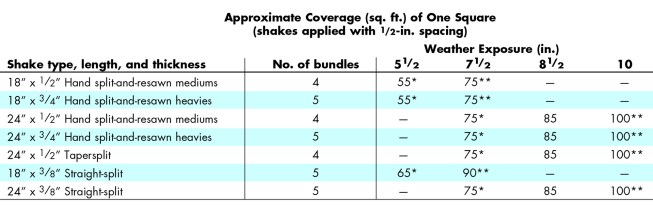

Estimating Wood Shakes and Shingles
A nominal square of shingles is four bundles, and a nominal square of shakes is five bundles, but this depends on the course exposure (Wood Shingle Coverage and Wood Shake Coverage, below). The steeper the slope, the more shingle that can be exposed.

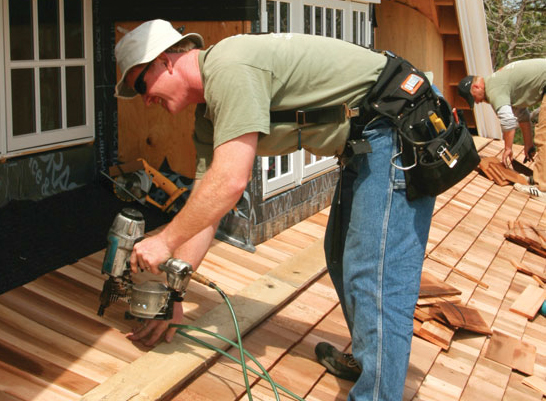

  • Install Cedar Breather® course by course just ahead of the shingles, tacking it in place with 5d galvanized box nails.
  • The seams are butted (not overlapped), and can be cut easily with shears.
Sheathing Options for Shakes
Because the irregular surface of hand-split shakes makes them somewhat self-ventilating, they may be installed over either spaced or solid sheathing in most cases.
Spaced sheathing for shakes is a must in hot, humid regions, however, because the shakes need a greater drying potential. For shakes, spaced sheathing usually consists of 1x6s spaced on centers equal to the weather exposure of the shakes.
Solid sheathing for shakes is preferable in three instances: on roofs with slopes of less than 4:12; in snowy regions where windblown snow could penetrate the shakes; and in earthquake-prone regions where the sheathing must act as a shear diaphragm.
