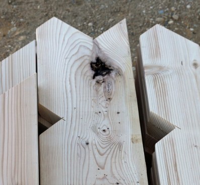

Knots
The influence of a knot on the mechanical properties of a wood member is due to the interruption of continuity and change in the direction of wood fibers associated with the knot.
Larger-diameter trees (a) produce more knot-free wood than smaller-diameter trees (b).
The influence of knots depends on their size, location, shape, and soundness; attendant local slope of grain; and type of stress to which the wood member is subjected. The shape (form) of a knot on a sawn surface depends upon the direction of the exposing cut. A nearly round knot is produced when lumber is sawn from a log and a branch is sawn through at right angles to its length (as in a flatsawn board). An oval knot is produced if the saw cut is diagonal to the branch length (as in a bastard-sawn board) and a “spiked” knot when the cut is lengthwise to the branch (as in a quartersawn board).
Although a knot itself is as strong as the rest of a piece of wood, the area near the knot is weak because of crossgrain. If a piece of lumber is milled when the log is still green, the knot is said to be “tight.” If the growth layer of the tree is dead, however, the knot will be loose or fall out when sawn.
In general, knots have a greater effect on strength in tension than compression; in bending, the effect depends on whether a knot is in the tension or compression side of a beam (knots along the centerline have little or no effect).
Grading rules limit the number of knots in structural lumber because the distortion of grain around the knot reduces a board’s strength. All these knots are in #2 SPF: A tight, intergrown knots (left); a spike knot (center); and an encased knot (right). The encased knot will resist (or transmit) little or no stress, but there is usually less distortion of grain around one, and therefore it is graded as equivalent to a tight knot of equivalent size.
Grading rules limit the number of knots in structural lumber because the distortion of grain around the knot reduces a board’s strength. All the knots shown above are in #2 SPF: A tight, intergrown knot (left); a spike knot (center); and an encased knot (right). The encased knot will resist (or transmit) little or no stress, but there is usually less distortion of grain around one and, therefore, it is graded as equivalent to a tight knot of equivalent size.
Intergrown (or live) knots resist (or transmit) some kinds of stress, but encased knots (unless very tight) or knotholes resist (or transmit) little or no stress. On the other hand, distortion of grain is greater around an intergrown knot than around an encased (or dead) knot of equivalent size. As a result, overall strength effects are roughly equalized, and often no distinction is made in stress grading between intergrown knots, dead knots, and knotholes.
In tension, knots along the edge of a member cause an eccentricity that induces bending stresses, and they should therefore be more restricted than knots away from the edge. In simply supported structural members subjected to bending, stresses are greater in the middle of the length and at the top and bottom edges than at midheight. These facts are recognized in some grades by differing limitations on the sizes of knots in different locations.

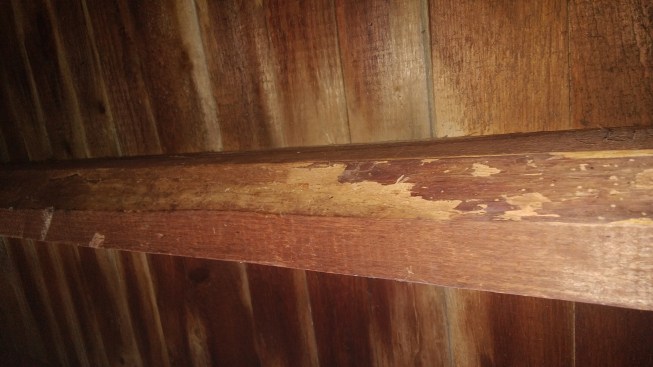

Wane refers to bark or lack of wood on the edge or corner of a piece of lumber, regardless of cause (except manufactured eased edges). Requirements of appearance, or the need for full edge bearing generally impose stricter limitations on wane than does strength. Wane is therefore limited in structural lumber.
Wane, shown here on a ceiling joist, is common on ungraded framing stock in old buildings. However, it is rarely a structural problem except when it reduces the bearing area of a beam.
