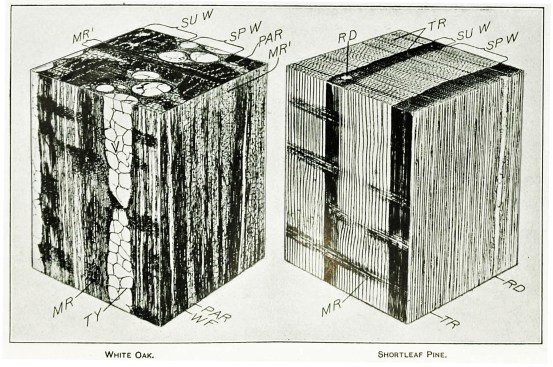

In each cube, the top view represents the transverse, or "end," surface; the left view, the radial, or "quartered," surface; and the right view, the tangential, or "plain sawn," surface. On both samples:  SU W: summerwood; SP W: springwood. On the left, hardwood sample: V: vessel (or pore); TY: tyloses in a vessel; PAR: parenchyma cells (dark areas); WF: wood fibers; MR: small medullary ray; MR': large medullary ray. On the right, softwood sample: TR: tracheids, which make up the bulk of the wood; MR: ordinary medullary rays; RD: resin ducts (voids between cells).

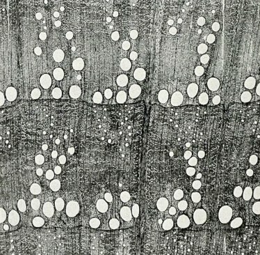

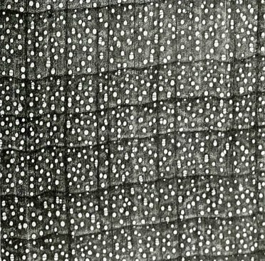

The single most identifiable difference between the two types of wood is that hardwoods have pores (or “vessel elements”). Individual pore cells are separated by perforated plates, and align end-to-end up the trunk. (In the image above, two pore cells are shown on the left side of the sample at left.) Water is conducted up the trunk of a hardwood tree by passing from pore cell to pore cell, driven through the permeable plates by a combination of forces:

The wood of white oak is somewhat heavier than the wood of red oak. Its heartwood pores are usually plugged with tyloses – growths on the cell walls  – which make the heartwood nearly impenetrable to water and provide good decay resistance.
White oak (hardwood)
Most red oak comes from the Eastern States. The size and arrangement of the large pores make it distinct from white oak. It does not form tyloses so the pores remain open and not as water or decay resistant as most white oaks, and the these open pores contribute to the  fairly high shrinkage of red oaks upon drying. Surprisingly, rapidly grown second-growth wood is generally harder and tougher than the finer textured old-growth wood.
Red oak (hardwood)

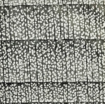

Sugar maple is known as a "hard maple"; it is denser and stronger than red maple or silver maple. It's strength comes primarily from the thickness of the cell walls in the fibers that run vertically up the trunk. This photo shows a close-up of endgrain and the fibers are visible as the dark areas between the pores; they are clusters of many fiber cells sliced crosswise.
Sugar maple (also known as hard maple; hardwood)

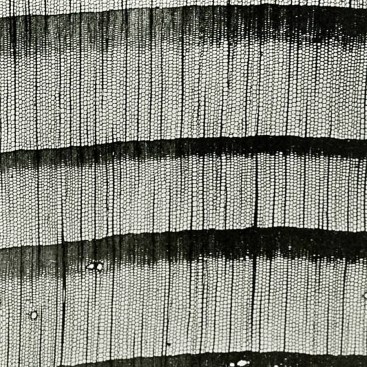

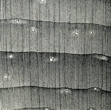

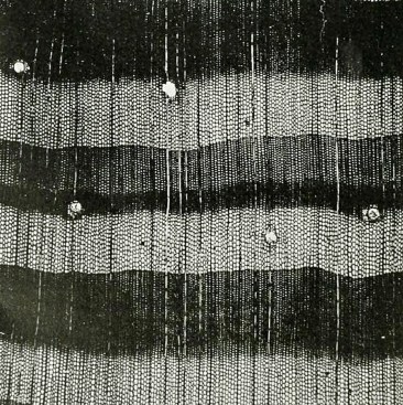

Instead of round pores, softwoods have long, rectangular tracheid cells that overlap vertically. These cells serve as both the wood structure, and a means to move water. The tracheids have circular “pits” at each end that connect to adjacent tracheids and are covered by a membrane.
Water flow up a softwood tree is driven by the three forces described above (osmosis, capillary action, and evaporation pressure), which move water across the pits from tracheid to tracheid in a zigzag fashion through the overlapping tracheids.
Douglas Fir
Douglas fir (softwood)

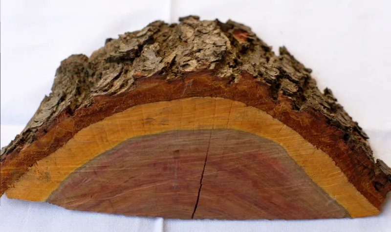

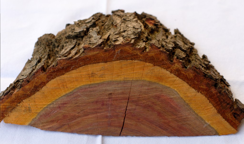

Sapwood vs. Heartwood
Sapwood is located next to the bark. It is the active part of a tree that conducts the water (sap) from the roots to the leaves. As a rule, the more vigorously growing trees have wider sapwood layers. Many second-growth trees of salable size consist mostly of sapwood.
Mussklprozz
Cells in the heartwood, the inner part of the tree, no longer conduct water up the trunk. As a tree grows, the cells harden and fill up with deposits of various materials that frequently give the wood a much darker color. In hardwoods, the pore cells grow tyloses , which appear in the pores like foam, that traps materials (gums and precipitates) and causes the cells to harden, usually making the heartwood stronger and more durable to weathering than sapwood.
Unless treated, all sapwood is susceptible to decay. In some woods, including redwood, western red cedar, and black locust, material deposited in the heartwood makes it heavier and more resistant to crushing than the sapwood.

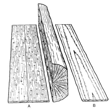

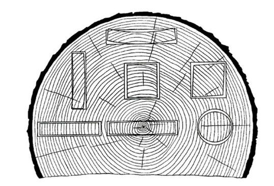

Plainsawn vs. quartersawn lumber. Lumber can be cut from a log in two distinct ways:
  1. When cut along a tangent to the annual rings, lumber is called “plainsawn” in hardwoods and “flat-grain” or “slash-grain” wood in softwoods.
  2. When cut radially (parallel or near parallel to a radius of the growth rings), lumber is called “quartersawn” or “vertical-grain” wood.
Quartersawn, or vertical-grain, lumber (A), cut radially (or near radially) to the rings, is sometimes preferred for its straightness, but plainsawn, or flat-grain, lumber (B) has more interesting grain patterns
Quartersawn lumber is usually not cut strictly parallel with the rays, and plainsawn boards are often far from being tangent to the rings. In commercial practice, lumber with rings at angles of 45° to 90° with the wide surface is called quartersawn, and lumber with rings at angles of 0° to 45° with the wide surface is called plainsawn.

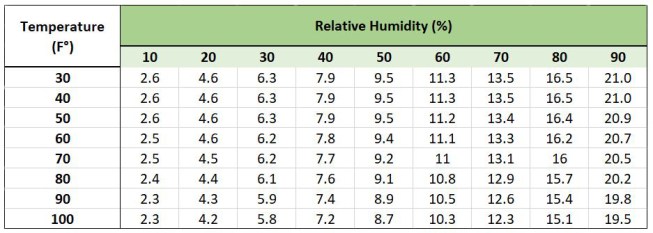

Moisture content. Sapwood’s moisture content is usually higher than heartwood’s (though not in all species). Moisture can exist in wood as a liquid or vapor within cell cavities or as water bound chemically within cell walls. The moisture content at which cell walls are saturated (with “bound” water when no water exists in cell cavities) is called the “fiber-saturation point.” This averages about 30% moisture content for all species.
The moisture content of wood below the fiber-saturation point is a function of both the relative humidity and the temperature of the surrounding air. The relationship between equilibrium moisture content, relative humidity, and temperature is shown in Table 1 (below).
Table 1: The moisture content of wood changes as a function of the temperature and relative humidity. For example, if a space is 30°F and 80% relative humidity (for example, in an attic in winter), the wood there will slowly rise to 16.5% moisture content.
Wood in buildings is almost always undergoing at least slight changes in moisture content as the temperature and relative humidity of the surrounding air change. These changes usually are gradual. Short-term fluctuations tend to affect only the wood surface. Protective coatings such as varnish, lacquer, or paint will slow down the moisture content changes but will not stop them entirely. The general goal in seasoning and storing wood is to bring the wood near the moisture content that it will typically have in service. The protective finish then helps to slow down the changes and keep the moisture content within a more stable range over its service life.

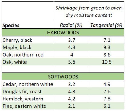

Wood shrinks most in the direction of the annual growth rings (tangentially), about one-half as much across the rings (radially), and only slightly along the grain (longitudinally). The combined effects of radial and tangential shrinkage can distort the shape of wood pieces. The image above shows the distortion that is most likely in boards, depending on where they are cut from the tree.
Wood shrinkage is affected by a number of variables. In general, greater shrinkage is associated with greater density. The size and shape of a piece of wood may also affect shrinkage. So may the temperature and rate of drying for some species. Radial and tangential shrinkage for a few common species ate shown in Table 2 (below).
Table 2: Shrinkage values of selected woods along the rings (tangential) and across the rings (radial).

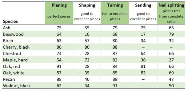

The ease of working wood with hand tools generally varies directly with the specific gravity (density) of the wood. The lower the density, the easier it is to cut the wood. A species that is easy to cut, however, does not necessarily develop a smooth surface when it is machined. Consequently, many U.S. hardwoods have been tested for machining properties. The results for a few species are given in Table 3 (below).
Table 3: Machining properties of selected hardwoods. The numbers represent the percentage of pieces with desirable characteristics in testing by the Forest Products Laboratory.
Three major factors other than density may affect the production of smooth surfaces during machining:
  • Interlocked and variable grain: Interlocked grain is characteristic of tropical species. It can cause difficulty in planing quartered surfaces unless attention is paid to feed rate, cutting angles, and the sharpness of knives.
  • Hard mineral deposits: Hard deposits, such as calcium carbonate and silica, can dull all cutting edges. This is worse when the wood is dried before milling.
  • Reaction wood: Tension wood in hardwoods, especially, can cause fibrous and fuzzy surfaces and can pinch saws due to stress relief. The pinching may result in burning and dulling of the sawteeth.
