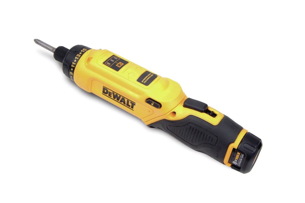

Shown here in the in-line configuration, the tool also adjusts to a pistol-grip shape. Note the built-in battery gauge and the trigger used to activate the gyroscopic sensor that controls the speed and direction of rotation.

Late in the summer DeWalt released the DCF860, a new 8-volt max stick driver—with a twist. Instead of using a standard forward/reverse rocker switch, it regulates speed and direction with a gyroscopic switch that follows the user’s wrist movement. The mechanism is intended to give the operator more control for greater precision. My first reaction was, “Is there any real benefit to this or is it just a novelty?”
To find out, I resolved to avoid using my subcompact drill/drivers for a month and use the DCF860 for every job it could handle. At first I struggled to get used to controlling the tool in such a nonstandard way, but before long, the tool’s action became second nature. Okay, maybe third nature—it’s hard to suppress the expectation that a tool will “go” when you pull the trigger.

Pulling the trigger of the DCF860 starts a gyroscopic sensor that marks the tool’s orientation in space—the starting position. Rotating the tool from this position while holding the trigger down causes it to spin in the direction of rotation. The farther you rotate it, the faster it spins. Turning the tool back to the starting position or releasing the trigger stops it.

The gyroscopic driver does have its quirks. To avoid over-rotating your wrist and operating the tool in an uncomfortable position, you have to cock your wrist in the opposite direction before every pull of the trigger. Also, it’s best to use the clutch when snugging down fasteners, because the mechanism will not allow you to feather them in with short bursts of the trigger. The moment you release the trigger, the sensor forgets the previous starting position and you have to re-cock your wrist or twist it even farther to get going again.

Although the gyroscopic driver takes some getting used to, it is a worthy addition to the tool kit of anyone who regularly installs small screws and fasteners—low-torque applications where control is important. Likely users would include painters, electricians, service techs, HVAC mechanics, and other installers.
