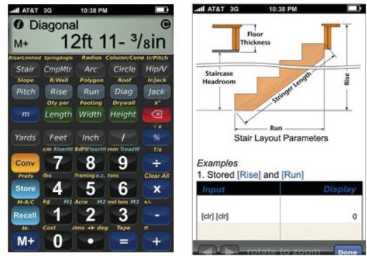

One of the first apps I bought was BuildCalc (www.buildcalc.com), a construction calculator that can compute rafter cuts, stair layout, compound crown cuts, and just about anything else done with geometry or trigonometry.
Although made by a different company, BuildCalc is very much like a Construction Master calculator. It has a similar key layout and more or less the same functions. The biggest difference is the interface: Instead of punching actual keys, you hit virtual keys on the touch-screen display. Because BuildCalc is on my phone and my phone is always with me, I now have a calculator wherever I go. (If I forget to charge the phone, though, I’ll be without a calculator — so I continue to carry my old construction calculator as a backup.)
BuildCalc has a terrific built-in help feature, a short on-screen manual that makes it easy to perform new functions. The help menu contains a series of slides that walk you through calculations.
Unlike a conventional calculator, BuildCalc — being software — is easily updated. During the months I’ve been using it, the app has been improved a number of times, and the maker has provided free online upgrades. BuildCalc is available only for the iPhone, but versions compatible with other brands of phones are supposedly in the works. BuildCalc sells for $20.

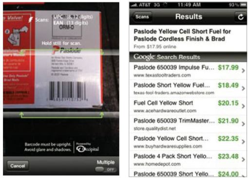

The RedLaser app (www.occipital.com) turns your iPhone into a bar-code scanner that searches the Web for pricing. To use it, you aim the phone’s camera at a bar code and wait for vendors and prices (from Google Product Search) to appear on the screen. I recently used RedLaser at the lumberyard to get a better deal on a siding nailer. An online vendor was selling the tool for $100 less than the lumberyard. When I showed this to the salesperson, he matched the online price. Not a bad return on an app that costs $2.
