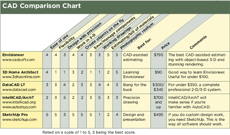

This time, I wanted to skip the work-arounds and find options that would provide a decent end-to-end design solution on a reasonable budget. I originally set the bar at around $500, but quickly found that I was a couple of hundred bucks low. However, I was able to find capable 2-D/3-D packages for under a grand.
I focused on the three general functions a JLC reader might need: 3-D presentations, working drawings, and CAD-assisted estimating. With those functional areas in mind, I spent the last few months soliciting, installing, and testing dozens of CAD products.
The vast majority were too generic or too simplistic, or required a rocket scientist to figure them out. So for this roundup, I settled on four product families: Cadsoft’s Envisioneer and little brother 3D Home Architect, DataCAD LT 11, IntelliCAD plus ArchT, and the wild card — SketchUp Pro. Not all of them satisfy every one of my three functional criteria, but they are all worthy additions to your digital toolbox if you accept their limitations.

Of the products reviewed here, SketchUp is by far the king of working directly in 3-D space. 3D Home Architect and Envisioneer both let you add and edit items in 3-D (initial drawing is done in a 2-D floor-plan window), while DataCAD LT and IntelliCAD/ArchT are more old-school: You do most of your drafting in a 2-D window and have to load a 3-D generator to see the results.

All of the products reviewed except SketchUp and 3D Home Architect have precision 2-D capability, and even SketchUp can give you rough elevations — as well as sections and floor plans — by simply slicing the 3-D model. 3D Home Architect has no 2-D drafting capability at all, making it practically worthless for working drawings, but it does allow you to add dimensions to floor plans and notes to various views for presentations.
Conflict checking. We’ve all had that set of plans where the ductwork runs through the skylights because somebody didn’t bother to check drawings for consistency. Even if you’re starting from a very complete 3-D model, these errors can still occur with 2-D/3-D CAD unless you can overlay your floor plans in some way to check for conflicts. DataCAD LT, IntelliCAD/ArchT, and Envisioneer all do well in this regard.

And finally, for bonus points, you should be able to print multiple drawings at different scales on the same sheet, say a floor plan at 1/4 inch = 1 foot and a cabinet detail at 1/2 inch = 1 foot. Of the products in this round-up, only the IntelliCAD/ArchT bundle has that capability.

None of the consumer-related CAD programs I tested, including 3-D Home Architect, could fulfill all of those requirements. They could count but not calculate; or they could calculate but wouldn’t allow me to change what was being calculated — for example, the materials that I wanted to use in a 2×6 wall.
Envisioneer’s configurable materials database makes it one of the best CAD-assisted estimating products available today at any price.
Like more conventional 2-D CAD programs, SketchUp Pro can count and report on the number and type of components in the model, but since you’re not defining objects for walls, framing, and so forth, a basic window or fixture schedule will be the best you can do, and that will require programming.
IntelliCAD/ArchT creates the lists and counts, but requires third-party estimating software (or a good programmer) to actually get the information out into a usable report.
Of the packages in this roundup, only one — Envisioneer — shines in the estimating realm, with a fully configurable materials database and complete flexibility about how those items take off from the model.
