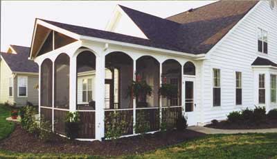

My company specializes in decks and porches. We keep ten two- to three-person crews in the field and build more than 90 screened porches every year. To compete against the many superb craftsmen in my area, we've had to develop methods and construction details that enable us to work efficiently and make a profit but still produce a porch that says quality.

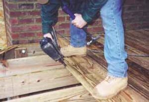

Many builders screen the underside of the porch deck or install a screened skirt panel around the porch perimeter to keep insects out. We prefer to use Madison's C-select 2x6 tongue-and-groove boards for a solid, gap-free porch floor (see Figure 1). The product we use is kiln dried after treatment, which eliminates the warping, twisting, and splitting common with ordinary wet PT lumber.
Figure 1.The author installs 2x6 pressure-treated T&G decking to prevent insects from entering between the floorboards of a screened porch. The decking is blind-nailed through the tongue to conceal the fasteners.
The boards are reversible, with a square-edge finish on one side and a V-groove edge on the other. We typically install the boards diagonally across the joists, V-groove up, and blind-nail the boards through the tongue to conceal the fasteners. There's a good reason I run my decking diagonally. Whenever you run decking perpendicular to the joists, you end up with scattered butt joints, which degrade the deck's appearance. By running the decking in opposing diagonals from a central point, you can cover a large surface with no end-butts. It's a clean, stylish look. If a sundeck surrounds the porch, the two structures will share a common floor frame. I use gapped 2x6 Trex decking for the outside portion. To back the seam where the Trex meets the T&G decking, we install 2x6 PT blocking on the flat between joists, flush with the top edge (Figure 2).
