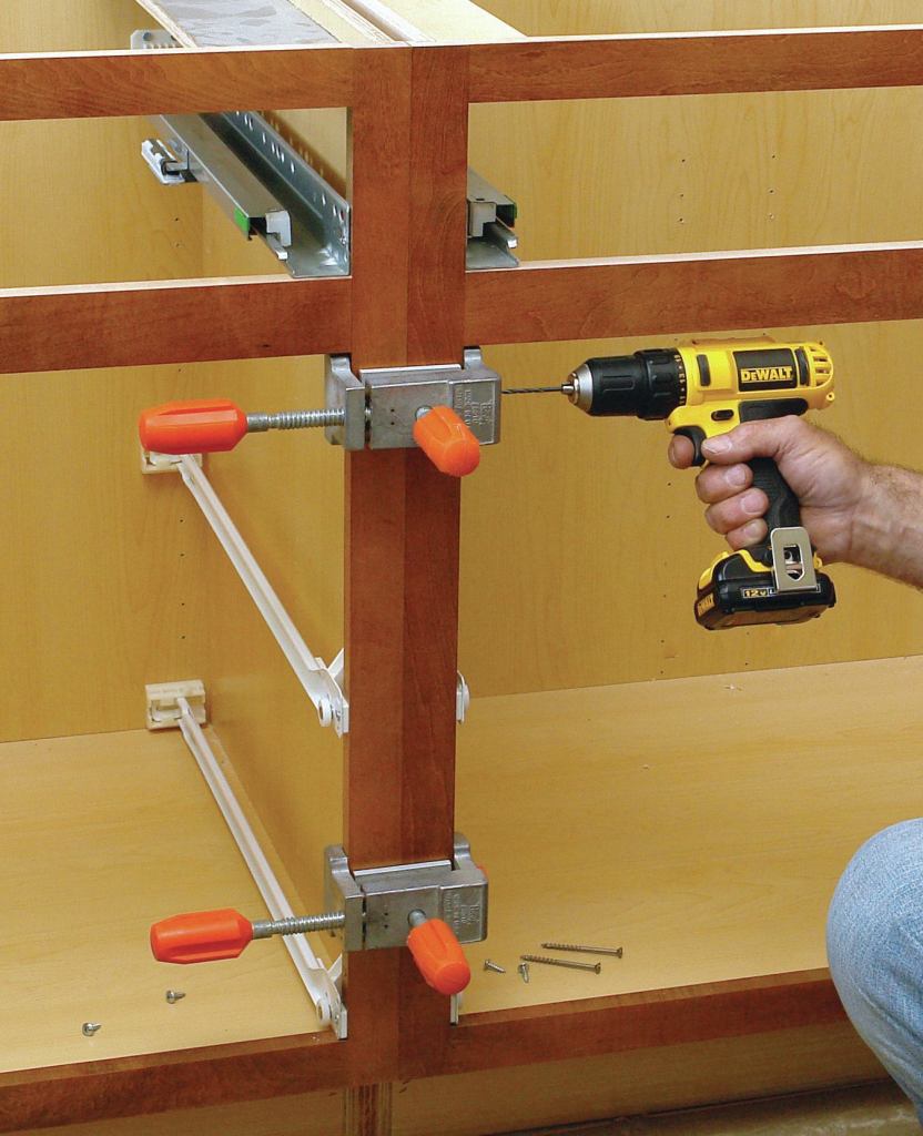

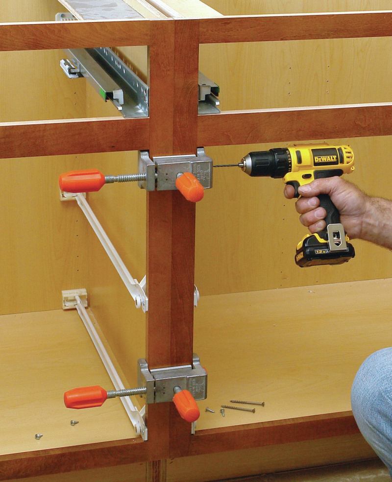

Crescent City, Calif., carpenter David Montez reports that he has been using Pony Cabinet Claw clamps for several years to help speed the work when installing face-frame cabinets. The dual-action clamps draw neighboring cabinets tight while flushing up the meeting stiles. Built-in drill guides make it easy to bore pilot holes and screw the stiles together before removing the clamps. The clamps are made by the Adjustable Clamp Co. (adjustableclamp.com) and currently cost about $62 per pair at Amazon.com. — B.G.
