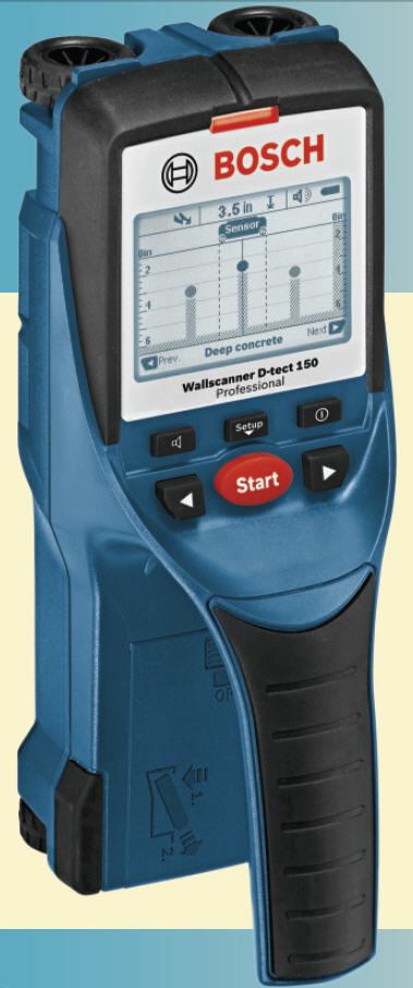

Bosch Wallscanner D-tect 150
Radar Vision
To use Bosch's futuristic Wallscanner D-tect 150 wall/floor scanner, you turn it on, select one of seven modes for scanning anything from deep concrete to drywall, and then roll the scanner slowly and continuously over the surface on its four rear wheels. The tool's "Ultra-Wide Band Radar Technology" detects wood and metal studs, live and nonlive wires, copper pipe, plastic pipe, rebar (including rebar up to 6 inches deep in cured concrete), and other materials. A backlit LCD screen indicates the type, depth, and width of the material. Four AA batteries provide power. The scanner (including batteries and a case) costs about $1,000. Bosch, 877/267-2499, boschtools.com
