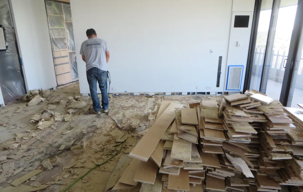

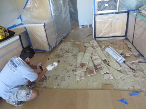

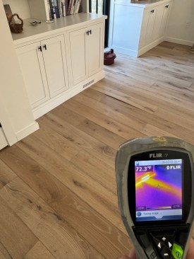

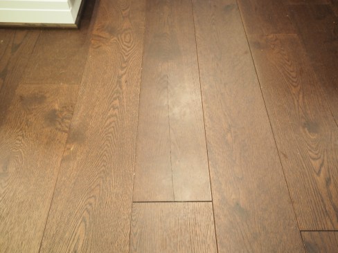

We started installing “engineered” wood floors years ago, expecting that their multi-layer construction would be more stable and show fewer shrinkage cracks in our dry winters. Unfortunately, we’ve seen enough of these floors fail that we are now very cautious about installing them at all. This past winter, two floors failed during a cold, dry month; one will likely need to be torn out and reinstalled, while only two boards were affected on the other, so that will be a straightforward repair. As with most callbacks, the worst part of these types of failures is disappointing our clients and the strains put on the project schedule and our company reputation— challenges we prefer to avoid. In this article, I give my perspective on what causes engineered flooring failures, look at the reality of manufacturers’ (non) warranty coverage, and share a couple of steps we take to minimize risk.

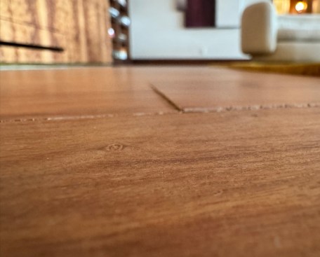

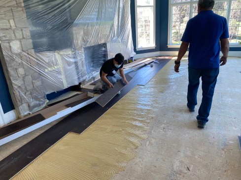

There are three main installation methods for engineered flooring: floating, nail/staple down, and glue-down. The problems we’ve seen occurred most often with glued-down applications when the indoor humidity was poorly controlled.

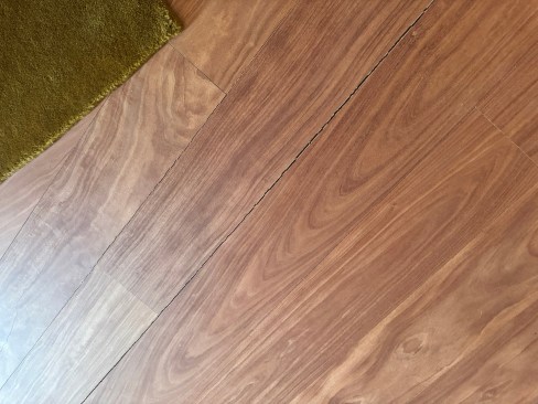

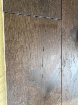

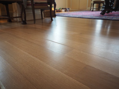

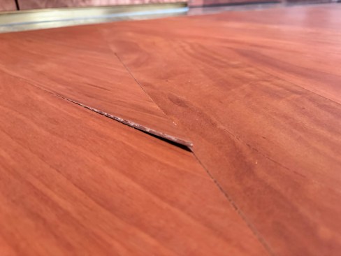

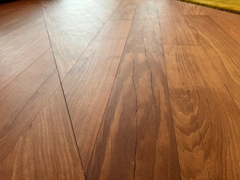

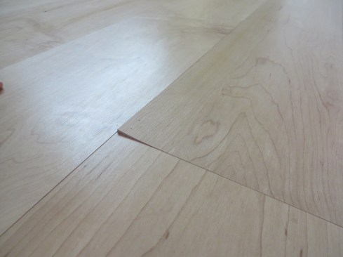

The problems come in winter, when indoor relative humidity in a leaky building in our area may go below 15% for several weeks, and stay in the low 20s even longer. In these conditions, the top lamella loses moisture to the dry indoor air and each piece of flooring becomes a bit narrower. Unlike a piece of solid wood, the top layer of engineered flooring is glued to layers below in a cross-grain construction. Wood shrinks across the width much more than along the length, so the layers below the lamella, with grain running perpendicular to the lamella, don’t shrink much at all. The top layer shrinks, but the layer below does not. Eventually, some pieces of the flooring fall apart from the stresses, and we get a call about edges or corners rising up, or large cracks appearing in the middle of the pieces.

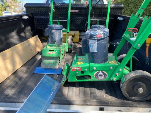

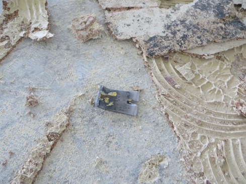

Strength of the glue. Today’s glues are incredibly strong, as you know if you’ve ever had to remove a glued down floor. We usually have to use chipping hammers or a power scraper. Glue seems to restrain the bottoms of the boards more than fasteners do, and the glue layer likely reduces the ability of the bottom layers to change moisture levels with ambient conditions (the glue is not very moisture-permeable). That can lead to moisture differences between the top and bottom pieces.

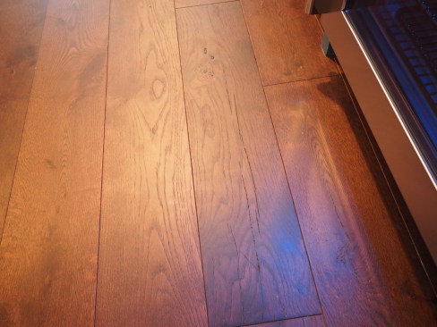

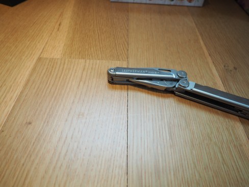

Width of the boards. With wider boards, there’s more total shrinkage of the top lamella and more stress on the joint between the top layer and layers below. Our worst failures were on 9- and 7-inch flooring, while flooring that’s less than 5 inches wide has only failed once for us.
Species and cut of the top layer. As with solid-sawn flooring, quarter-sawn oak shrinks less than plainsawn oak, and much less than plainsawn maple, for example.
Relative humidity in the space. All the issues we’ve seen can be traced directly to low humidity conditions. Some happened in buildings that were leaky and the wintertime indoor humidity was running very low; others happened when humidifiers were turned off or malfunctioning.

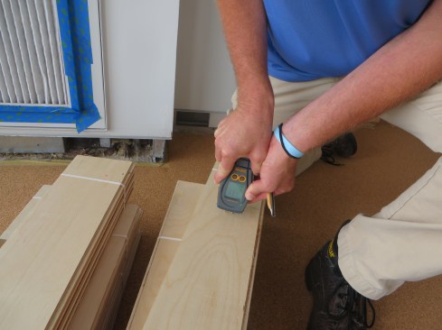

All in all, in our experience, manufacturers don’t cover cracking or delamination. We decided we would be happy to install engineered flooring, but since wider flooring is so risky, we discuss the issue with clients and have them sign a specific warranty exclusion for these problems. We also don’t install flooring with a moisture content higher than around 11%.
