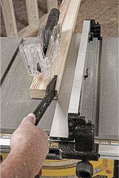

If you visit dewalt.com, you can view several videos that clearly demonstrate the key features of these saws. Built on a tubular-steel roll cage, the saws use DeWalt’s signature rack-and-pinion fence-adjustment system, but the maximum rip capacity has been stretched to a class-leading 32 1/2 inches. Our other table saws can rip 4-foot-wide panels in half, so we can already rip them to any dimension, but the extra support to the right of the blade is occasionally helpful. A separate strip of extruded aluminum flips over the top of the fence from right to left to support the right-hand edge of your stock when you’re making wide rips. With a quick adjustment, it can also serve as a low auxiliary fence to make narrow ripping safer and easier. A push stick is clipped to the back of the fence within easy reach.

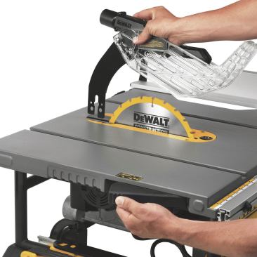

Like all of the latest jobsite table saws, the two DeWalts feature a modular tool-free safety system that is clearly not an afterthought. It includes a blade guard that’s permanently attached to a splitter, separate anti-kickback pawls that quickly snap on, and a separate riving knife that can be used instead of the guard assembly. The guard assembly has a rear dust port that helps eject sawdust away from the table and can hook to a vacuum.
To install or remove the guard assembly or the riving knife, you simply raise the blade all the way up, pull the release lever at the left end of the saw table, and slip the splitter or riving knife in or out. We normally don’t use blade guards with our jobsite table saws because they often get in the way, but this system is so well designed that we’re all at least using the riving knives to prevent binding.

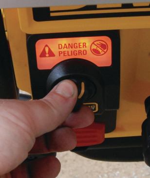

The unique Guard Detect on/off switch on the DWE7499GD works like a typical paddle switch when the blade guard is properly installed. If you try to switch on the saw without the guard installed, however, a flashing light warns that the blade is unguarded. You then have to turn the switch’s bypass knob once to start the saw, and you have to repeat this two-stage actuation every time you turn on the unguarded saw. This procedure does remind us to work safely, but it currently adds $150 or more to the cost of the saw.

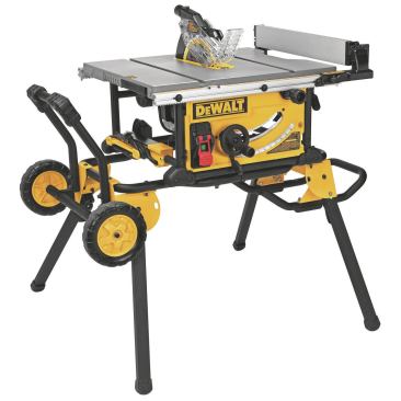

Folded up, the 90-pound rigs are easy to load into and out of our vans and pickups, though they won’t quite fit under a tonneau cover. They also roll easily around our jobsites on two firm wheels that offer a satisfactory amount of cushion.
Setup is simple. First, with the stand resting upright, you unfold all four legs toward you until they snap into the locked position. Foot pedals allow you to release and extend the two bottom legs without bending over. With the legs extended, you then pull the stand’s top handle to tip the saw up onto them. Reversing the process is just as easy.
