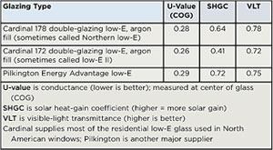

When you compare the performance numbers of three representative glazing products, you can see that the solar transmittance of so-called Northern low-E 178 glazing is about 55 percent greater than that of the commonly available 172 low-E glazing (also called low-E II), while its conductance (U-value) is a tad higher, as is its VLT (see chart, below).
Because it allows more of the sun's infrared energy to pass through, 178 glazing is definitely preferable in cold climates — except for cases involving large expanses of west-facing glazing or significantly overglazed southern facades.
An even more effective glazing for the south side of a passive solar building might be Pilkington Energy Advantage glazing, which is better at allowing the sun's heat and light in, though slightly worse in insulating value.
