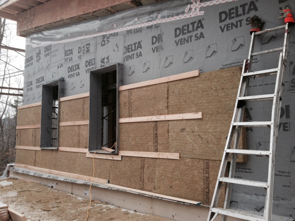

Where the ecohome.net team broke new ground was their uncompromising position on insulation. “Rather than putting $10,000 in a furnace, we said ‘Let’s put an extra $10,000 into insulation and reduce the size of our heating infrastructure.’ We’re not hemorrhaging heat from every corner of the house,” Reynolds states.

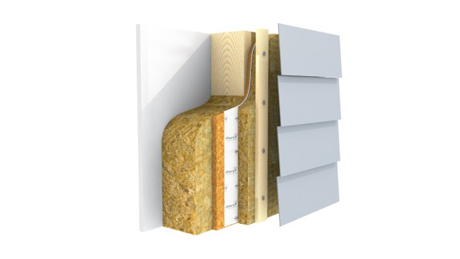

To staunch the “energy bleeding,” Reynolds doubled-down on stone wool insulation from Roxul®, chiefly ComfortBoard™ product, a rigid stone wool insulation sheathing board that is non-combustible, water repellent, fire resistant, and sound absorbent.
Edelweiss House is packed with ComfortBoard, top, bottom and sideways. Under the slab? It’s super-insulated to R-32 with an 8-inch thick pad of ComfortBoard. The walls? There are 8 inches of ComfortBoard and another 5.5 inches of Comfortbatt stone wool insulation for an effective R-50 rating. The ceiling? More ComfortBoard for a whopping R-95. Canadian winters and summers bounce right off Edelweiss House.
“ComfortBoard doesn’t trap moisture. It’s a very breathable wall assembly. That’s something we wanted,” Reynolds explains. “Leave it in the rain and the water just runs off. There’s no moisture risk. Can you say that about XPS or EPS foam?”
