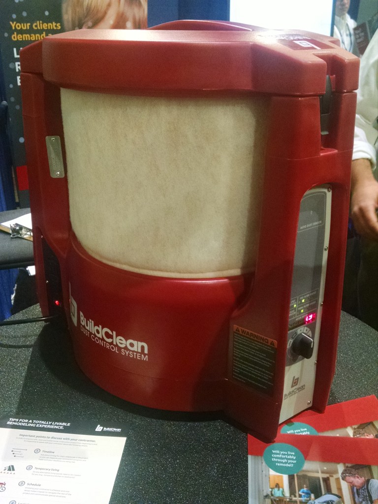

The BuildClean unit pulls air from all sides, first through a prefilter and then through a HEPA filter, before clean air is discharged thorough the back side (not shown). The prefilter will eventually load and cake up with coarse particles. The general recommendation is one prefilter per job, assuming the job is a major remodel that lasts 30 to 45 days, while the HEPA filter inside the unit is good for about 5,000 hours of operation, according to BuildClean.

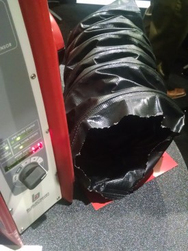

A flexible vent duct can be attached to the exhaust port. While optional, using the vent duct is the only way to get the work space under a negative pressure, which is what you want to keep dust from migrating through the barrier (e.g. Zip Wall) you erect between the work space and the living space in an occupied home.

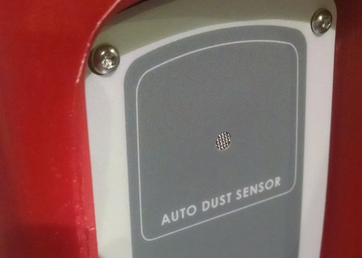

When set on "auto" mode, a dust sensor on the BuildClean unit senses the particulate concentration in the surrounding air and adjusts fan speed accordingly. The unit will also step up the fan speed as the pre-filter becomes caked with dust, so you are able to maintain a constant rate of airflow without having to fuss with the unit through the course of a job.

The heart of the BuildClean system is a 38-pound unit, which acts as an environmental air filter to pull airborne particulates out of a work space. It must be used in concert with a plastic barrier to isolate the workspace from the living space. You wan to maintain negative air pressure in the workspace to keep dust-laden air from migrating into the living space The unit pulls air through a circular prefilter, then through a HEPA filter, before it exhausts the filtered air through a 6-in.-dia. flexible duct out a window or door. (Seal around the hose with cardboard and tape to maintain negative pressure in the workspace.) One unit can reportedly depressurize a 20′ x 30′ x10′ sealed workspace.
