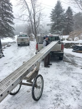

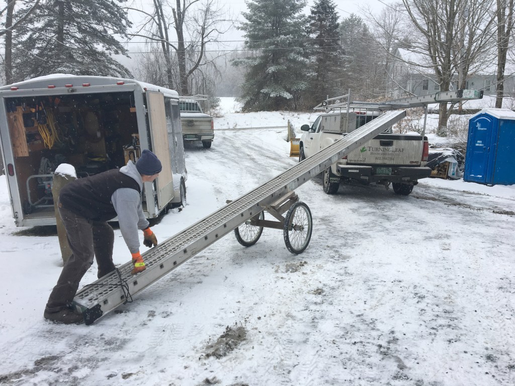

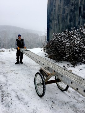

I picked up this tip when training at the Yestermorrow Design/Build School years ago to learn more about timber framing: To move heavy beams and posts, I now always use a timber cart. I built my own cart out of scrap lumber, a 5/8-inch steel axle rod from an old garden cart, and a pair of 26-inch-diameter wheels.
The key to using the cart is to balance heavy loads over the cart’s midpoint, the axle. I use it to move 24-foot staging planks, ladders, beams, and piles of framing lumber.
My homemade version is approximately the same height as my sawhorses. By pushing down on one end of the cart, I can raise a timber or staging plank high enough to easily set one end on my truck’s ladder rack or on a set of staging, and then slide it up into place.
