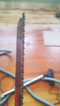

Designed for cutting thick metals, the Diablo Steel Demon blade features wide gullets between the teeth. The gullets help clear the metal flakes that would otherwise build up between the teeth (as they do on the typical bimetal blade), creating lots of heat and slowing down the cut.

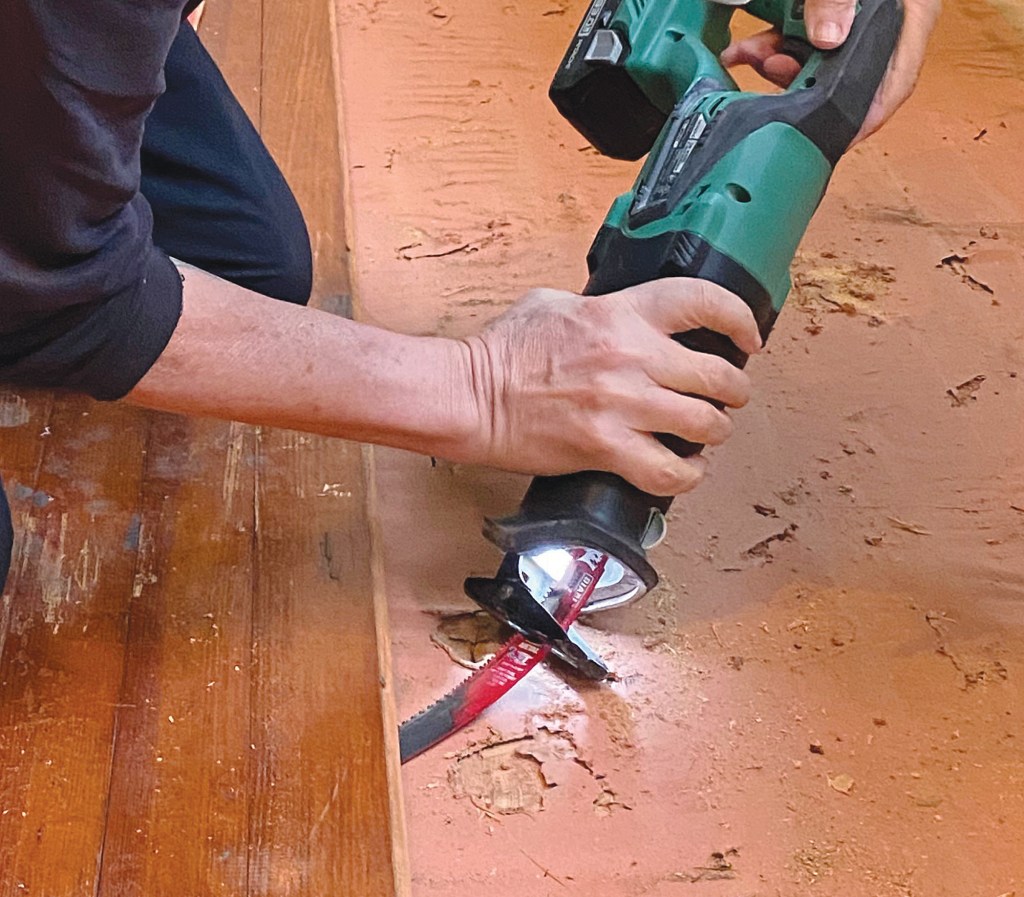

I was recently faced with a tough steel-cutting problem—taking out thick cut nails on a floor that needed to be removed so insulators could open up the floor and apply SPF to an otherwise inaccessible crawlspace. We needed to replace the floor afterwards so precision demolition was paramount, but the old wrought-iron nails were proving to be a huge obstacle. They smoked carbide multitool blades that ordinarily work well on steel nails. I could slip a 9-inch metal-cutting recip saw blade under the floorboards by bending it, but this was slow going—upwards of 40 seconds per cut and one blade for about 15 nails. At that rate, I would need about 10 blades and it would take about three hours just in cutting time.
Salvation came from the Diablo Steel Demon. Taking a cue from the Toolbox Buzz crew, I went for the longer-lasting blade. It zipped through each nail in about four seconds, and one blade did the whole job (upwards of 300 cuts). When I was done, the teeth looked unscathed. While wrought-iron nails are thick by nail standards, they aren’t especially thick compared with, say, a wide-flange steel beam. Yet the hardness of the nails was my challenge, and the Steel Demon’s aggressive carbide overcame it easily.
