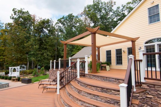

Trex has introduced three new Pergola Shade Structures, named Air, Balance, and Vision, along with a selection of finish colors—Mango, FireFly, Inferno, Lagoon, and Palm. They’re manufactured and sold by Structureworks Fabrication under a trademark licensing agreement with Trex. The structures are made of cellular PVC with structural aluminum cores and stainless steel hardware. The Air and Balance models come with a motorized canopy that lets the user choose between shade and sun, while the Vision model offers a customizable frame and canopy.

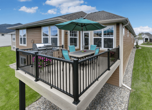

Atlantis Rail has introduced a new off-the-shelf Spectrum post that attaches to the surface of the deck. Previously, fascia-mounted posts were the only type the company offered. The new surface-mounted posts can be used with Atlantis’ RailEasy and HandiSwage Spectrum systems. Posts are offered in black and metallic silver and straight and stair post designs. Straight posts are available in 36-inch and 42-inch heights.

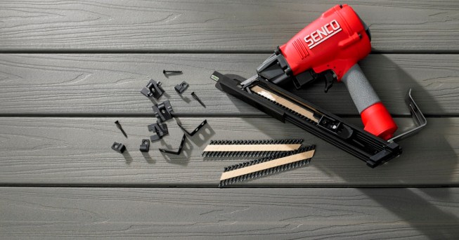

With Senco’s new SHD150XP pneumatic gun, deck builders can install Senco Mantis brand hidden deck clips up to 80% faster than with traditional methods, the firm says. Fasteners are loaded at the rear of the magazine, and clips are inserted into a patented EZ Slide at the front of the tool. A magnet holds the clip in the slide while the installer pushes it into place and then pulls the trigger to drive the fastener. The fasteners are driven like standard collated nails but can be backed out like a screw. Mantis clips come in three sizes; part of the clip slides under the deck board, slightly elevating it off the joist so the decking and framing can dry more easily.

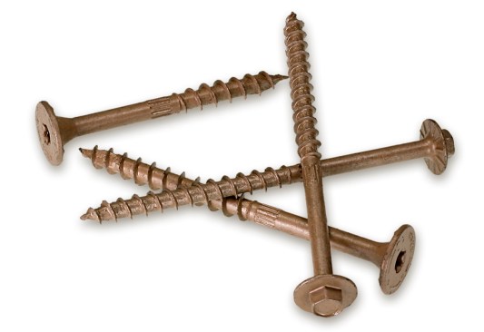

Simpson Strong-Tie has designed a code-compliant solution for attaching wood guardrail posts that’s being offered as a high-strength alternative to through-bolting and lag screws. The Strong Drive SDWS Timber screw is a structural screw that installs without pre-drilling in most applications and has been tested in accordance with ICC-ES AC273 (Acceptance Criteria for Handrails and Guards). Strong Drive SDWS Timber screws are available in six lengths ranging from 3 inches to 10 inches. The low-profile head design provides a clean look after installation, and the screw’s Double-Barrier coating provides corrosion resistance that’s equivalent to hot-dip galvanization.

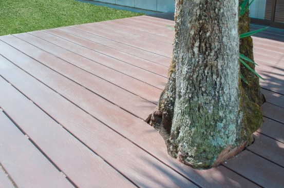

AlluraUSA, a subsidiary of Plycem, is introducing a decking made of a seemingly unlikely material: fiber cement. According to the company’s director of product development, the fiber cement is mixed with plastic fibers and other additives to make it pliable. The boards, which are 1 inch thick and 6 inches wide, will span 16 inches on center with a 406-pound load rating. Although the product is new to the United States, it has been sold in Costa Rica (where it’s manufactured) for five years. Advantages include a Class-A fire rating and the fact that it doesn’t heat up in the sun like PVC or wood fiber composites. Boards weigh 3.1 pounds per linear foot (compared to 2.5 for other composites) and come with square or grooved edges.
