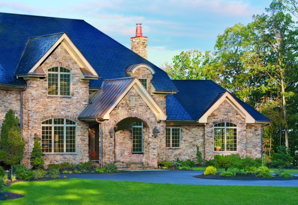

“The mason is traditionally the guy that does the stone work, and we love that guy because he does the installation better than anyone,” says Ramsay Hawfield, director of marketing for Eldorado Stone, whose Countryside Cypress Ridge is shown at the top of this story. “But during the downturn we saw a lot of trades asking, ‘what else can I do?’ We’ve definitely seen other groups showing more interest in manufactured stone because it’s an option to make more revenue.”
