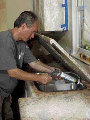

Counters are transported to the site in sections and glued to a plywood subtop with thick dabs of epoxy. This counter is made from 13/16-inch material. There would be no need for a subtop if it were made from 1 1/4-inch structural stone.

Deep overhangs are common at breakfast bars but they need to be supported from below. I tell contractors to sit on the edge of the subtop, and if it deflects more than 1/8 inch it's not sufficiently stiff. The easiest way to support the overhang is to put end panels or decorative brackets underneath. If the client doesn't want brackets or panels, you will have to devise a less obvious means of support. In this case, we use concealed angles or plates. My favorite method is to route slots in the subtop and insert steel angles so they are flush with the surface. It will probably take several angles to sufficiently stiffen the overhang. The pieces will cantilever over the edge, so one-third should be in the overhang and two-thirds should land on the cabinets.
Here, the installer applies epoxy to steel angles in the subtop that will support an overhanging section of counter.
