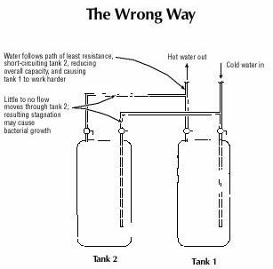

Once it's determined that adding a second tank makes sense, there are two basic piping methods that work well: reverse-return and series. Each offers independent operation if one water heater fails or needs servicing. Other incorrect piping methods commonly but erroneously used to add a tank not only perform poorly but may also cause stagnation and ensuing water-quality problems.
This common but incorrect method of adding a second water heater results in unbalanced flow and stagnation in tank 2.
