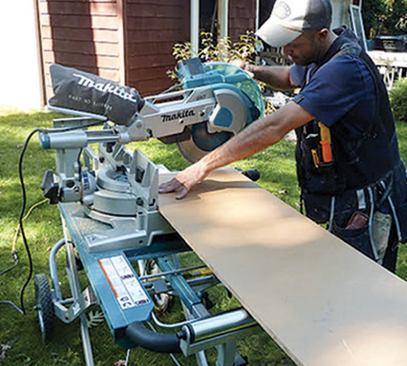

The older I get, the more I tend to favor smaller and lighter power tools that are easy to move around the job site. That didn’t stop me from buying Makita’s big and heavy LS1216L sliding compound miter saw last year, though. I couldn’t resist its cutting capacity: a full 15 inches wide at 3 5/8 inches deep, more than any other sliding compound miter saw I’m aware of. My crew and I don’t always need this much capacity, so we don’t use the LS1216L as our primary saw; but when we’re trimming out a wide frieze or working on an unusually deep built-in, we don’t mind lugging around a saw that measures almost 3 feet long and weighs close to 60 pounds – as long as it will do the job.

I’ve owned a couple of generations of Makita miter saws over the years and have always found them to be accurate and well-built. This model is no exception. Even though it’s been bouncing around in a gang box for several months now, my LS1216L cuts as smoothly and accurately as the day I unpacked it. Crosscuts are dead-on, while vertical cuts are off by only about 1/32 inch over 3 1/2 inches – not enough to bother re-adjusting the stops, in my book.

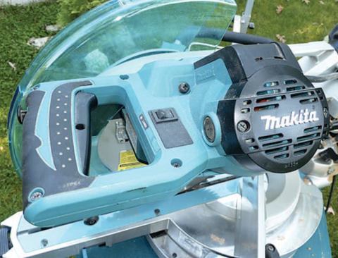

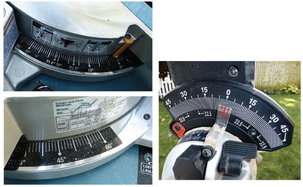

The saw shares many of the attributes and features of its (slightly) smaller brother, the 10-inch LS1016L: easy-to-read miter and bevel scales, dual rails, an angled gear-driven motor, and a laser (designated by the “L” after the model number). In fact, the two saws look nearly identical, the only noticeable difference being the 1216’s larger blade and slightly larger footprint (about 4 inches longer and 2 inches wider than the 1016’s). The 1216 is also heavier than the 1016, but only by about 5 pounds. It has an electric brake, soft start, and electronic speed control, and comes with a dust bag, a material hold-down clamp, and self-storing blade and adjustment wrenches – pretty standard fare.
Blade. One of the first things I do when putting a new miter saw into service is replace the stock blade with a better-quality one, often at a cost of $60 or more. With this saw, I didn’t have to; after almost a year in service, the high-quality blade continues to deliver smooth, splinter-free cuts in materials ranging from hardwoods to plywood. We use the saw mostly for cutting siding and exterior trim, and would only change the blade if we had to cut more demanding material.
Fence. The 5 1/2-inch-tall sliding fence is a welcome departure from Makita’s usual efforts in this area. As much as I’ve been a fan of the company’s miter saws, I’ve always wished its fences were taller, since I prefer to cut most of my moldings standing up. In the past, I’ve just added taller wood subfences to support wider stock, but that decreases the crosscut capacity of the tool. The upper sections of this fence slide smoothly out of the way for miter or bevel cuts.
Handle. I also like the rubberized horizontal D-handle, a welcome improvement over the vertical handles found on previous Makita models. Vertical handles – particularly those with safety buttons – have always felt awkward to me. The 1216’s cushioned handle does have a safety button that you have to depress to operate the tool, but the button is located in such a position that you can engage it while gripping the handle naturally – no uncomfortable wrist and thumb contortions required.
Laser. Unfortunately, the laser on the saw has been a disappointment. It worked intermittently for a few months and then quit altogether. For me a laser isn’t a critical feature, but having to take the machine in for service so early was a hassle.

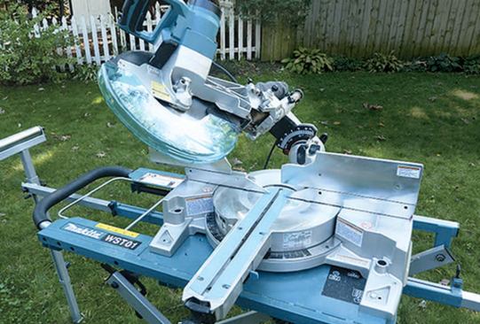

Makita’s accessory saw stand is heavy, awkward, and – at $350 – expensive. It doesn’t provide continuous support of the material, and I found it too low to work with comfortably. If you need to be able to roll the saw around, this stand may be worth a look – but for the way we work, I found it easier to transport and store the saw without it.
