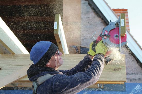

We’ve been using this new sidewinder constantly for small jobs, and we love having it on our framing jobs as an extra saw that we can carry around for quick cuts without a cord. It’s easy to adjust and comfortable to hold. The blade guard works well, although, like most, it gets hung up and needs a helping thumb on the lever when the saw is making a bevel cut at an acute angle. The saw bevels to a bit over 51 degrees and can cut through a 2-by at that angle. I’ve found the bright LED headlight to be a blessing for interior work. It has a 10-second afterglow when you release the trigger.

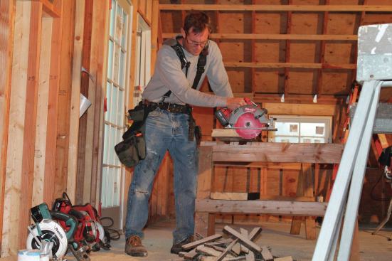

Assisted by a helper with a stopwatch, I counted the number of freehand crosscuts I could make per minute with each saw through a well-seasoned, full-dimension 2×10 spruce staging plank with consistently scattered small knots, repeating the test several times for each saw and averaging the results. I equipped each saw with a new Diablo 24-tooth framing blade and fully charged all the batteries.
Among the cordless saws, the Milwaukee 7 1/4-incher cut 13 to 14 slices per minute, the Milwaukee 6 1/2-incher cut 12 slices per minute, and the Makita 7 1/4-incher cut 15 to 16 slices. On the other hand, our corded Milwaukee 7 1/4-incher easily cut 30 slices per minute and our corded Ridgid 6 1/2-incher cut 26, making it clear that corded saws still definitely rule for production framing.
