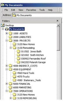

Left on its own, Windows will sort everything alphabetically, which means a seldom-used folder named "Archives" will always appear ahead of "Really Important Projects" in the list. That's why I prefer a numeric system, which can be an extension of your familiar accounting cost codes, such as NAHB's chart of accounts (see Figure 1).
Figure 1.A uniform file and folder naming convention is a must when setting up a network file server. A numeric system that follows your existing job or cost codes is ideal. The 2001 version of NAHB's chart of accounts can be downloaded from www.mountainconsulting.com/library/.
