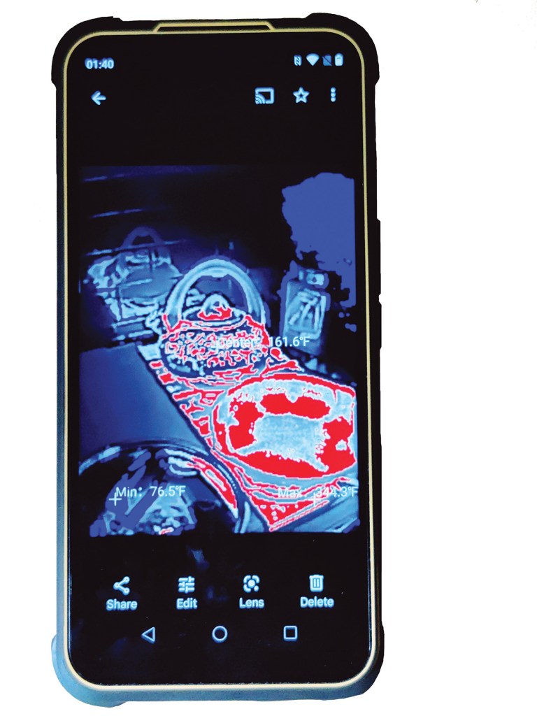

Anyone working on a building envelope knows the value of a thermal-imaging camera as a diagnostic tool. Thankfully, the price for a good one has dropped over the years from thousands to hundreds of dollars, making infrared cameras a lot more accessible. But as far as I know, up until the introduction of the AGM Glory G1S in late spring of 2022, the only IR smartphone option was the FLIR One, an oversized dongle that plugs into the USB-C port on an Android phone or the Lightning port on an iPhone. On the AGM smartphone, the thermal-imaging capability is built in, and even though it’s controlled by an app on the phone, it functions just like a regular camera phone to take high-resolution 256×192 pixel stills (in comparison, the resolution of the FLIR One Pro is 160×120 pixels) and 25 FPS video in several different black-and-white and color palettes. Not only that, the phone’s built-in camera has an outstanding IR night-vision capability.

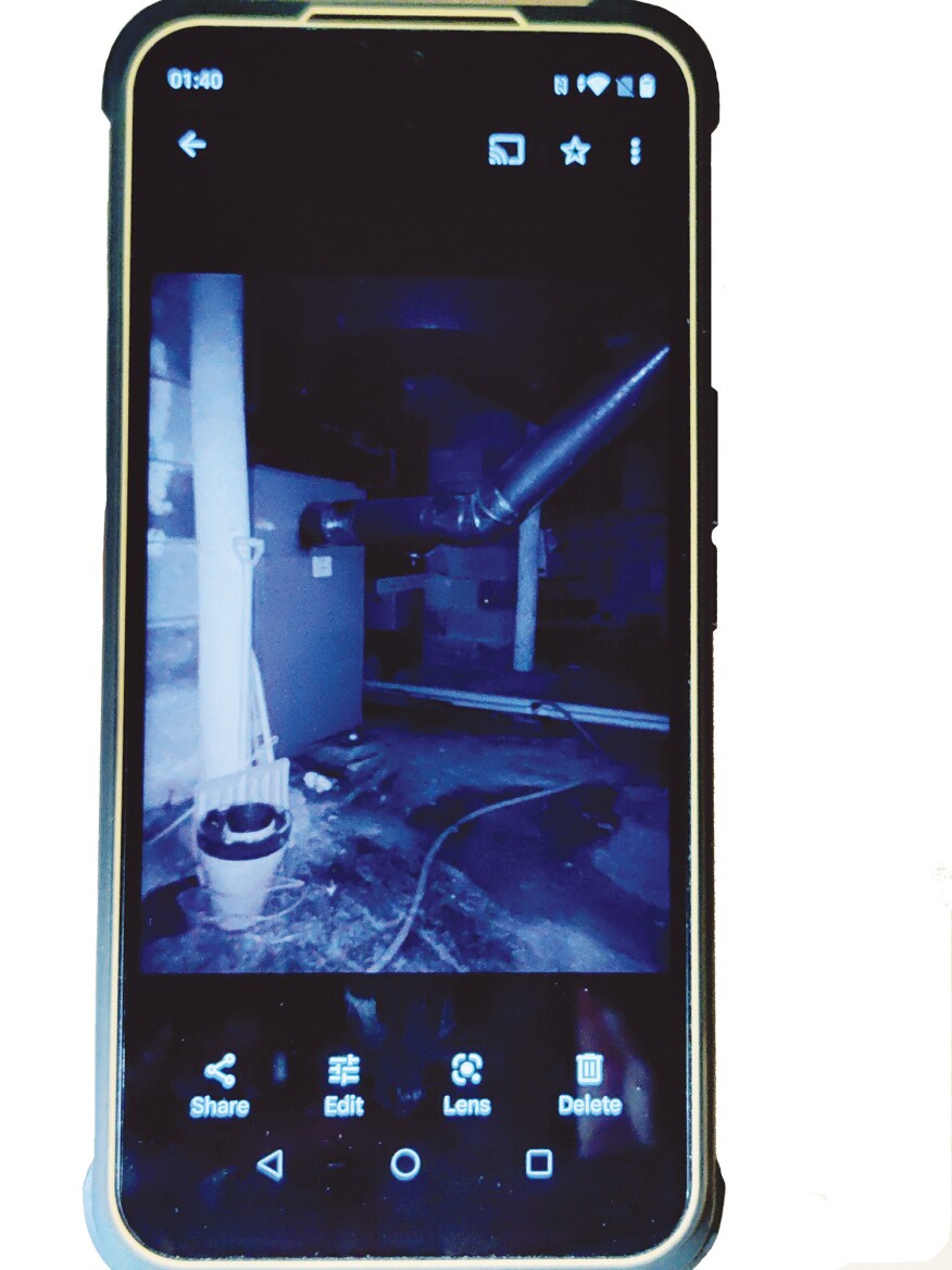

The AGM phone also has an impressive infrared night-vision mode. Here is an IR night-vision photo of a furnace in a basement—taken in total darkness.
