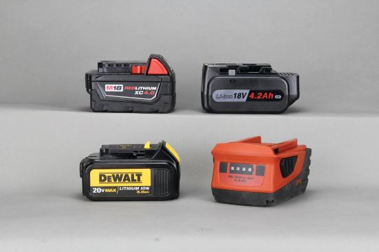

Battery: 18 volts; 3.0 Ah

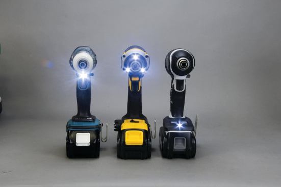

Features: Three speed ranges; ranges controlled by slide switch; push-button release chuck with one-handed bit loading; three LED lights; lights are trigger-actuated with 20-second delay; fuel gauge on battery; charger also charges 12V Max batteries; case is extremely compact
Comments: Solid second-tier tool; unique recessed bit holder in nose; bit is released by pressing a button above trigger; triple LED around nose provides effective lighting; only tool with onboard bit storage; also available in compact battery kit

Battery: 21.6 volts; 3.3 Ah

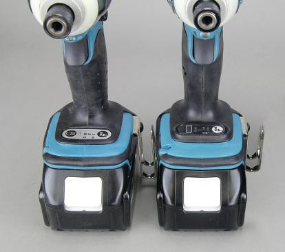

Makita LXDT01
Approx. charging time (supplied charger and battery): 30 minutes

Features: Three speed ranges; ranges controlled by push-button switch; one-handed bit loading; one LED light with 10-second delay; light can be disabled; warning lights for low battery, overheating, and locked motor; nose of tool glows in the dark; case is very compact
Comments: Solid second-tier tool; felt strong and eager in use and placed quite well in many of the power tests; could benefit from a battery fuel gauge
Makita LXDT06
Rpm: 1,400; 2,300; 2,800; T-mode = 2,800

Features: Three speed ranges and Quick-Shift mode that automatically downshifts under load; ranges and special mode controlled by push-button switch; one-handed bit loading; one LED light with 10-second delay; light can be disabled; battery gauge on tool; overheat warning light; nose of tool glows in the dark; case is very compact
Comments: Most compact tool in test; in unique T-mode for self-tapping (TEK) screws, driver runs in full speed until screw gets a bite; as load increases tool finishes drive at medium speed to avoid stripping the threads; only Makita model with a battery fuel gauge

Battery: 18 volts; 4.0 Ah

Battery: 18 or 14.4 volts; 4.2 Ah

Comments: A unique flexible-fuel tool that runs on 14.4-volt or 18-volt batteries; a top-tier performer; equally powerful with either battery; with 4.2-Ah 18-volt battery, had best runtime in the test; the lightest tool tested when fitted with 14.4-volt pack; could benefit from a battery fuel gauge
