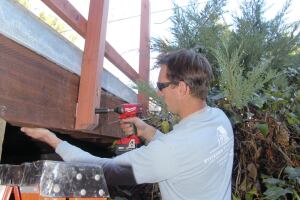

In keeping with Tools of the Trade’s last test of 18-volt impact drivers (Fall 2011), I tested runtimes by driving 1/4-inch by 31/2-inch coated Simpson SDS lags into the sides of thick Weyerhaeuser Parallam beams until each tool’s batteries were depleted. I drove the lags in groups of 10 to avoid overheating the motor or batteries. Since I used the same test procedures, you can compare the performance of these latest brushless tools with the tools tested in 2011.
The runtime would be greater in dimensional framing lumber because it’s not as dense as Parallam. Our testing routinely shows an increase of about 25%.
