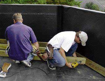

To avoid those problems, I worked out a design that suspends the deck frame an inch or two above the rubber roof, supported by parapet half-walls that rise above the roof plane as a continuation of exterior or interior house walls. That way, the deck structure never contacts the roof surface at all — instead, a continuous drainage space lets water (and dirt) flow freely off.
The author’s design for rooftop decks protects the structure and living space of the room below with a continuous EPDM roof. To allow free drainage and protect the roofing, the deck frame is suspended from the parapet walls.

The room’s roof framing, which is also the ceiling framing for the room below, really resembles a floor frame more than the usual roof frame (see photos, below).
The ceiling joists of the room below the deck are ripped to provide a slight pitch away from the house, then sheathed with 1/2-inch plywood (top left). Strapping helps ensure a flat drywall ceiling (bottom left).
The house walls do the work of supporting the above-roof walking deck, and the deck framing itself is sized to carry the design dead and live loads for our area, including snow loads. So although it is capable of considerably more, the roof-ceiling frame for the room isn’t actually subjected to loading much beyond its own weight. Depending on the dimensions of the space, I’ll use 2x8s or 2x10s for joists, with 1×4 strapping on the underside and 1/2-inch plywood sheathing on the upper side. We rip the tops of the joists to provide a pitch of about an inch, creating a gentle slope away from the house.
