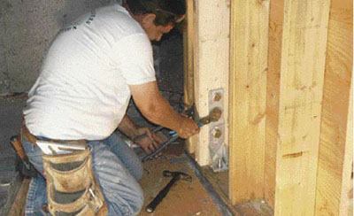

To do their part, the shearwalls have to be stiff enough to resist racking, and they must also be anchored against sliding and overturning. The stiffness comes from plywood or OSB sheathing (I use plywood). To pin the wall in place, the easy choice is a manufactured hold-down like Simpson Strong-Tie’s HD5 series, which I used on my current Rhode Island project. You could design your own connector if you could find an engineer to okay it, but in my experience it’s so convenient to work with Simpson products that I don’t bother looking for an alternative.

To get an actual shearwall with predictable strength, you don’t change much: It’s still 16-inch on-center stud framing with a single shoe and double top plate, typically sheathed with a 1/2-inch panel (or thereabouts), using 8d nails. But you need hold-downs of some sort at both ends of the wall — concrete anchors, or a floor-to-floor connector in the case of a second-floor shearwall. The hold-downs need to connect to a double stud, or sometimes even a single 4×4 member.
