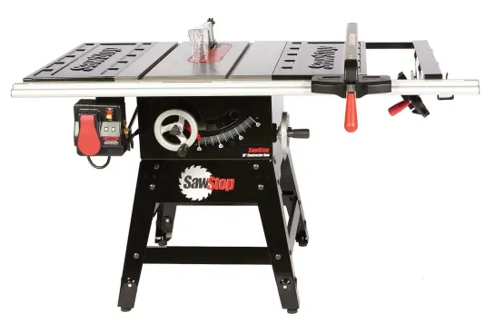

SawStop offers three base models: the Contractor Saw, the Professional Cabinet Saw, and the Industrial Cabinet Saw. Various upgrades and accessories let you tune each model to the work you do. I bought the Contractor Saw, adding an integrated mobile base along with a Biesemeyer-style T-Glide fence system that boosts the rip capacity to 36 ½ inches. Thanks to plenty of vibration-dampening cast iron and heavy-gauge steel, the rig weighs more than 300 pounds. The mobile base allows us to raise the heavy saw onto two wheels and two casters by stepping on a pedal, and to lower it back to the floor by stepping on the pedal and a release lever.
The 1.75-horsepower motor is pre-wired for 120 volts. To improve the performance when ripping hardwoods, I converted it to 240 volts by following the instructions in the owner’s manual. Not including the saw blade, our souped-up saw cost about $2,000.

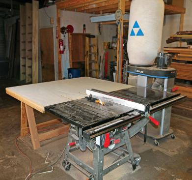

When setting up the saw, we always bolt a homemade melamine out-feed table to its convenient L-shaped rear rail and hook a Delta dust collector to the 4-inch dust port. This setup needs some space, so on site we often convert the living room or garage into our ripping station.
It normally takes four guys to lift and carry the saw, and it’s a bit harder to set up than our DeWalts. But the saw is a pleasure to use because it accommodates long trim and wide panels and is precise, stable, and almost vibration-free. Dust collection is decent with our Delta collector, but the saw still emits a large amount of fine dust. A dust-collection blade guard is available that might be an improvement, but we haven’t tried it. Also, it isn’t practical to load this heavyweight into our Mercedes-Benz Sprinter van at the end of each day and take it home. Instead, we meticulously chain the saw, lock the house, and say a prayer.

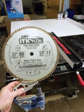

Our SawStop safety system has yet to save a finger, but we know it works. One of our carpenters accidentally touched the spinning blade with an aluminum straightedge. Boom! I had to replace the blade and the brake, but the straightedge survived.
