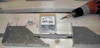

For the past couple of years, I’ve seen the magazine ads with William Shatner promoting EZ Stairs — but I never gave them a second look. I figured it was a DIY product for people who couldn’t lay out and cut a proper set of stringers.
Seeing them in action at DeckExpo, though, got my attention. After a short learning curve, you can prepare a pair of 14-foot-long stringers with the EZ Stairs brackets in 30 minutes or less — just try doing that with a framing square and saw.
The only cuts on the stringers you need to make are the top and bottom ones. The brackets screw to a pair of parallel 2x6s or 2x8s, which take the place of 2×12 stringers. Spacers precisely align the brackets and can be set for riser heights between 6 inches and 81/4 inches and tread depths between 9 inches and 12 inches, following the spacer-setting chart. Structural risers 2×8 or deeper screw to the vertical face flange of each bracket and span between the stringers.
You can build up to 9-foot-wide interior and 7-foot-wide exterior stairs with no intermediate stringers. There is a limitation, however, that some users won’t like: The system doesn’t allow for open-end stringers with mitered skirt-to-riser trim detailing. The structural stringers house both sides of the staircase.
It’s easiest and fastest to make treads from 2-by stock, but finish decking can also be used for treads with the addition of accessory brackets and 2-by blocks.
The written instructions for making the top and bottom cuts on the stringers will make sense to seasoned stair cutters, but may leave others wanting more information. Before you try using EZ Stairs for the first time, watch the short animation video on the Web site (www.ez-stairs.com/3d.ram). It’s helpful to see the assembly process in order to fully understand the installation guide; but it’s after using the system once that you’ll fully appreciate the labor and material savings.
A set of eight pairs of brackets (which is enough for a nine-riser set of stairs) sells for just under $50, and a set of eight reusable spacers for the system is less than $15. — Mike Guertin is a builder and remodeler in East Greenwich, R.I., and a siding, roofing, and deck specialist at Hanley Wood’s JLC Live, DeckExpo, and Remodeling Shows.
