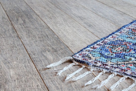

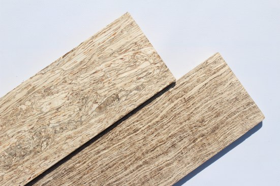

Many hemp building products utilize the plant’s fibers in somewhat predictable ways, such as for weaving textiles or reinforcing cementitious materials. However, manufacturers are now creating “reverse-engineered” wood alternatives in the form of pressed hemp boards and blocks. In Murray, Ky., Fibonacci manufactures lumber, flooring, cabinets, frames, and furniture with hemp plants harvested within a 100-mile radius for its product, HempWood. The company subjects the plant fibers to high heat before compressing them in molds with a soy-based adhesive, or wood glue. Fibonacci’s aim was to recreate oak’s stability, hardness, and density in a workable, hardwoodlike material. HempWood may be cut, sanded, and finished like oak and is nearly twice as strong, according to its manufacturer. “The whole idea is to take something that’s weak and grows fast, and transform it into a replacement for something that’s strong and grows slow,” HempWood founder Greg Wilson said in a HempBuildMag interview.

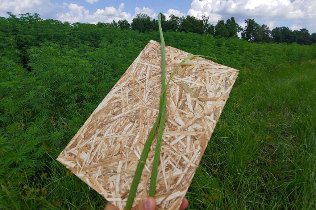

Durham, N.C.–based startup Plantd has similar aspirations. Co-founders Josh Dorfman and Huade Tan launched the company after searching for suitable biomass alternatives to trees. They recognized that hemp’s significant strength and carbon performance make it an optimal feedstock for residential building applications. With funding from a North Carolina Idea Seed grant, the manufacturer is prototyping a hemp-based OSB. By creating their own manufacturing processes—which are nimbler, as well as more mobile and economically accessible, than lumber mill machinery—Dorfman and Tan claim that the surrogate material will also be less expensive. According to the Dorfman, a new OSB plant can cost $400 million to construct, while a new Plantd facility costs $1 million. “Our approach eliminates the need for an eight-story tall, 4 million-pound press that the entire industry relies upon,” Dorfman says. “Instead, we build microfactories that are distributed near or in the markets where most houses are being built.” Unlike trees, hemp is a viable crop throughout much of the U.S., enabling a localization of farming and manufacturing that the engineered wood industry cannot attain. Furthermore, hemp can be dried in the same field from which it is harvested and does not require the energy-intensive industrial drying process of green timber.

Dorfman and Tan are eyeing Elon Musk’s $100 million XPrize for Carbon Removal, a four-year competition that aspires to remove 1 gigaton of atmospheric CO2 annually. In the first stage, the contest requires a demonstration of sequestering 1,000 tons of CO2 per year until 2025, which Dorfman claims can be accomplished with a little less than 100 houses worth of hemp OSB. “Our goals are to reach gigaton scales of CO2 capture, which requires producing materials at the scale of the timber, steel, and concrete industries,” he says.
