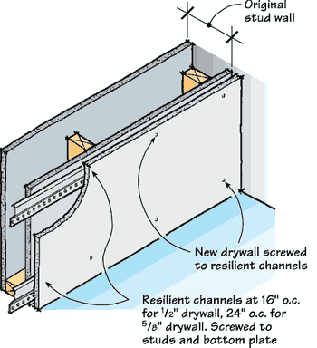

In many cases, noise transmitted directly through walls or floors may be a much greater nuisance than airborne noise. These sounds are caused either by noise in one room that vibrates the intervening floors or walls or by physical impact, such as doors slamming and footfalls. To get a feel for how this works, think of the drywall surface on one side of a 2×4 stud wall as a diaphragm that vibrates in response to sound pressure waves in the air or a door slamming against it. The studs, rigidly attached, pass these vibrations right through to the drywall on the other side, which passes the noise to the next room. The key to stemming this noise route is to isolate the elements of the wall from one another. An easy way to do this to an existing wall is to add a second layer of drywall on the far side, attached with resilient channels (see Figure 1).
Figure 1.To improve the sound-dampening ability of a existing stud wall top) or ceiling (bottom), add a second layer of drywall supported on resilient channel. The channel helps isolate the new wall of ceiling surface from any vibrational noise that might be carried through the original framing and drywall, reducing sound by around 40%. The channels act like springs to absorb the vibrations from the main wall, cutting the structure-borne sound by about 40%. (You can use a similar approach for the ceiling of a room with living space above.) An even better solution is to build a separate new wall (Figure 2), which will give you a cavity for new wiring and a surface for the receptacles.
