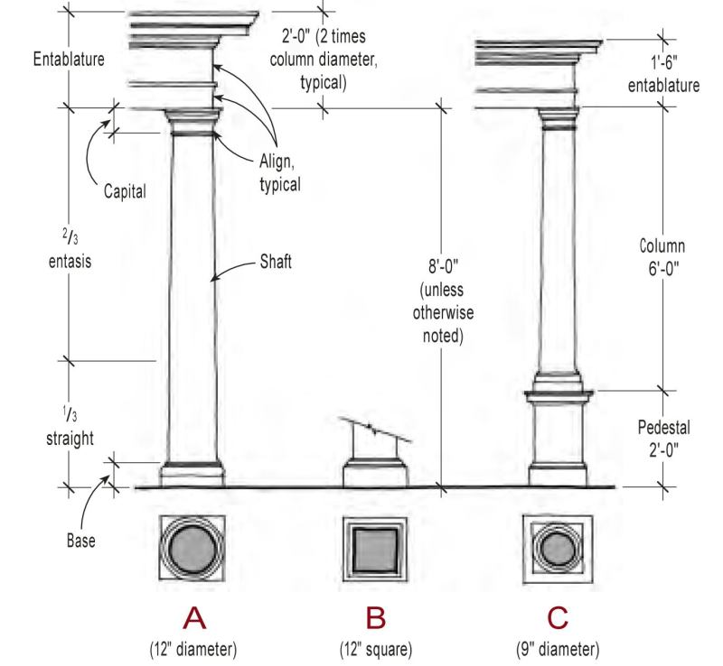

Column examples A, B, and C are roughly based on the Doric classical order. They are more formal and traditional than post examples D, E, and F.
A is fairly massive and supports an appropriately massive entablature. A column of this scale and detail is most appropriate on a large-scale, authentic classical reproduction; it would likely look overinflated and silly on most anything else.
As is typical of classical columns, the bottom third of the shaft extends straight up from the base diameter and the upper two-thirds of the shaft tapers, with a convex profile. This tapering is called entasis.
Column B is a square-plan version of Column A. It’s a tad less formal but equally robust.
Column C is of a more moderate scale. Sitting the 9-inch-diameter column atop a pedestal allows it to occupy the same overall height as full-height columns A and B without the girth. The entablature at is scaled down to accommodate the smaller column.
