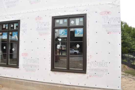

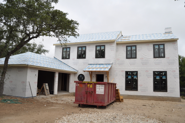

Tip #1: Drain the Rain – Housewrap and Air Sealing
Nothing kills a house faster than water. If you are building a house to last, you must pay attention to the waterproofing details. In this build, we used Tyvek Commercial D housewrap along with all their flashing accessories for the window and door penetrations. Here’s the video I shot of the Jeld-Wen window install using DuPont’s Best Practice methods. I’ve been using Tyvek for years now and it’s my go-to standard for a house with overhangs.
Windows have Flexwrap Sill Pans and Straighflash Jambs/head.  Use DuPont’s methods for setting a window and you’ll be using the best possible method to ensure a leak-free window.  Notice the Plastic cap staples hold really well.  I like the Stinger Cap stapler and Cap/Staple packs.  They work great!
I love these Quickflash Line Set panels for my HVAC penetrations.
Siga Wigluv Tape applied to all the joints in the OSB. We also air sealed the slab to bottom plate connection with a 12″ strip of Carlisle CCW 705

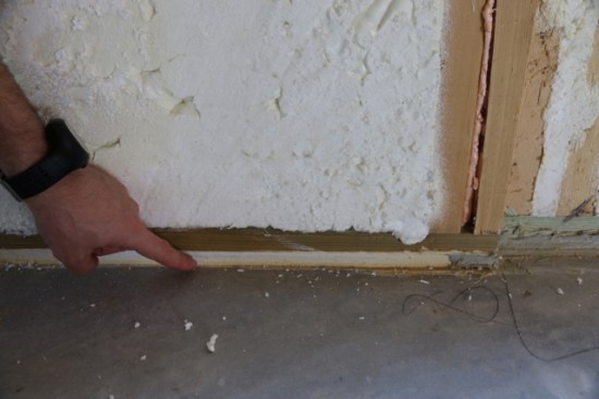

We also air sealed the inside bottom 2x plate to concrete slab connection with Tremco Dymonic caulk. I buy it in bulk sausage tubes and use a commercial sealant gun to save money.
We also used for the first time an air sealing tape called Siga Wigluv on this house to ensure the tightest possible envelope. More info on that install here at this video on the Siga tape install.

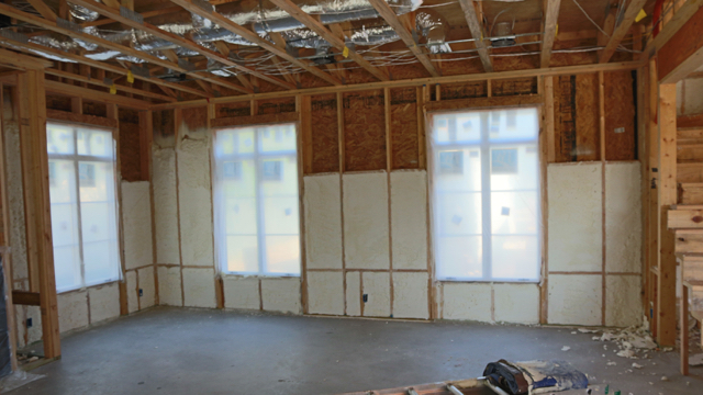

We used 2×6 exterior walls on 24-inch centers with California Corners and insulated headers. This makes for a very strong house, but one that utilizes the most space for insulation with the least thermal bridging. We opted against exterior rigid foam so advanced framing was vital to give the highest R-value we could get for our walls.
Tip #3: Insulation

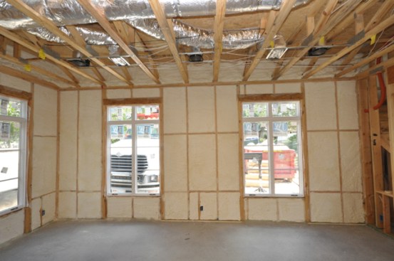

The walls have 5.5 inches of open cell foam, and the roof has 9 inches of open cell foam sprayed directly under the roof deck.
Those studs lining up with the floor trusses look awesome! Advanced framing definitely takes some pre-planning!
Insulated and ready for sheetrock.

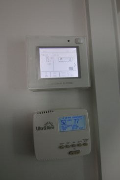

Upstairs hallway has a Mitsubishi controller for temperature, and a separate Ultra-Aire dehumidistat to control the indoor RH

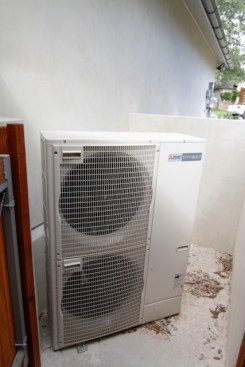

Here’s my 3 Ton City Multi Mitsubishi compressor tied to two indoor units. This unit is SUPER quiet and crazy efficient!
