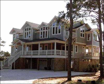

In Kitty Hawk, N.C., homes must be elevated at least 8 feet to rise above the base flood elevation. For elderly and disabled residents, however, this imposes a daunting challenge. Builder Paul Buske saw the shift in the home-buyer demographics over a decade ago and now provides an elevator to get above the BFE in nearly all of his homes.
