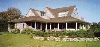

In our work on Nantucket Island, we have had the opportunity to rehabilitate several turn-of-the-century Shingle Style summer houses. The house named ‘Wideawake,’ profiled in this article and shown in the photo below, was built in the late 19th century in the village of Siasconset, a former whaling outpost that dates from colonial times. The house was expanded and renovated in 1914 by the architect Fredrick P. Hill as a guesthouse for the silent film star Robert Hilliard. By the time our clients purchased the property, the original cedar roof shingles had been replaced with asphalt, and much of the original detailing on the house had been removed or replaced with plain painted trim boards. To rehabilitate the house, we repaired and restored the original materials and detailing, effectively returning the house to its authentic Shingle-Style appearance.

‘Wideawake,’ a shingle-style summer house on Nantucket Island, was returned to its authentic 19th century appearance with the repair and restoration of original details by the authors. (Photo by Michael Meyer)

‘Wideawake’ provides an example of many of these Shingle Style adaptations to the seaside location. The house is wrapped on three sides by a sheltering porch, with deep overhanging eaves. The sharp eaves edge, made by mitering the roof sheathing directly to the beaded board soffit, eliminated the fascia board — a detail that we discovered had not proven very durable over time. Movement in the materials in response to changes in moisture content had opened the joint and allowed water to penetrate into the cornice and underlying structure. Our detail restored the knife-edge appearance of the eave but replaced the original miter joint with a fascia mold, which covers the end of the roof sheathing and soffit while maintaining the horizontal line of the roof. The 5/4-inch-butt red cedar roof shingles overhang the nosing to conceal the molding.
