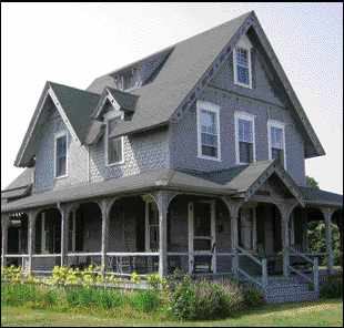

Figure 1. A striking example of the decorative use of pattern shingles is seen at Idlemoor — a home constructed on Nantucket Island in 1884. Most of original sidewall material (above) remains intact today.

A striking example of the decorative use of pattern shingles is seen at Idlemoor — a home constructed on Nantucket Island in 1884. Built in the Stick style, this house incorporates a variety of traditional cut-shingle patterns across its panelized exterior (Figure 1). Wood clapboards and three different cut shingles — applied with the butts aligned and staggered in five different patterns — combine to create a complex decorative expression from a simple kit of precut uniform elements. With continued maintenance of the painted slate blue-gray finish, most of the original sidewall material remains intact today. Although the shingle designs used on Idlemoor are no longer available, similar precut white cedar shingles are currently available in several traditional patterns from Maibec’s Victorian series shingles (www.maibec.com; 800-363-1930).
