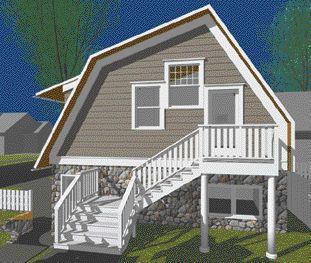

The traditional approach to trimming a gambrel lends an authentic feel even when the roof in question has a more contemporary look. We recently selected the Dutch Colonial style for an artist's loft over a new two-stall garage, partly because the primary residence has a gambrel dormer, but also because the multiple roof angles allowed the north-facing glass necessary for a painter's studio (see Figure 1). While the asymmetrical roof pitch is a bit more rakish than that of most Dutch Colonials, the split-faced granite base and cedar-shingle siding match more traditional homes in this older Minneapolis neighborhood.
Figure 1.The exterior detailing typical of traditional Dutch Colonial architecture relies on chunky trim dimensions, liberal use of bed molding, and a layered look where materials overlap. While most often associated with symmetrical roof forms, the same approach is also well suited to more contemporary roofs.
