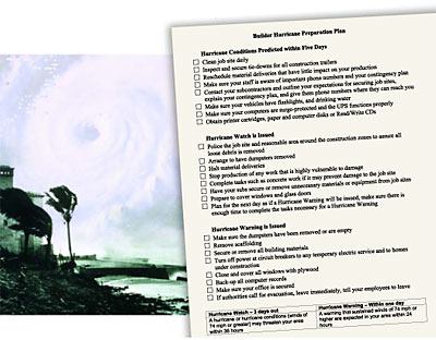

What's the first thing you'd do when a hurricane warning sounds in the middle of a job? A ToolBase TechNote entitled "Hurricane Preparedness for Builders," by the NAHB Research Center of Upper Marlboro, Md., offers a preparation plan (reprinted with permission at right), which itemizes tasks you might not have thought about beforehand.
In addition to the tasks on this checklist, the TechNote includes a number of other important considerations to be made both before and immediately after the storm. Some of the key preparations, which may not be so obvious at first, include:
