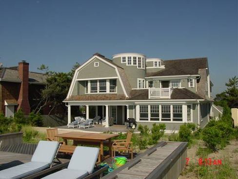

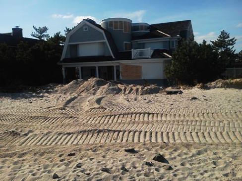

Almost all of that is high-end work: “Most of my homes are four million plus,” said Borden. And because most of the houses were built to FEMA-mandated modern codes, they provide an interesting test case. “They were all built to the higher elevation and the whole bit,” said Borden. “And I can show you pictures of two oceanfront houses where we have dug three feet of sand out of the first floor.” Evidently, said Borden, Sandy’s storm surge flooding was higher than the official Base Flood Elevation for that stretch of shoreline.
“One house, they had a big 14-foot by 22-foot dune-top deck,” says Borden (see slideshow), “and that deck just came apart. It floated in and opened up the doors of the house — went right through the storm shutters, blew the doors open, and allowed the house to be compromised. The dune in front of the house was at elevation 23, and the house was at elevation 15. And it just wasn’t enough.”
