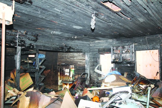

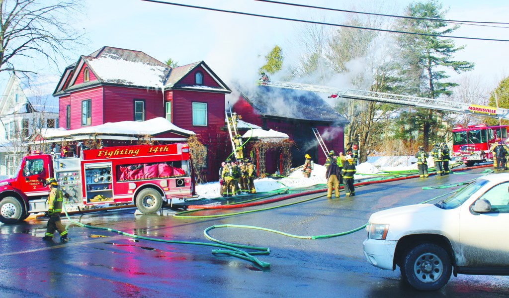

The fire started in an attached carriage barn.
Credit: Andrew Martin of the Vermont Community Newspaper Group

Surveying the site, I saw that the fire had been largely contained to the home’s attached carriage barn. A one-story section of the home (connecting the carriage barn to the main house) and the main house itself were mostly smoke-damaged. The couple told me that they had recently moved from out of state and had lived in the home only a few months. Compounding their problems, a lot of their belongings were still boxed up from the move and stored in the carriage barn when the fire occurred, which resulted in significant property loss. The displaced homeowners were living in a rental house.
It destroyed most of the family's stored belongings.

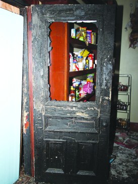

Abutting the barn, a butler’s pantry was severely damaged as well.

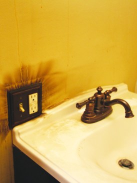

Smoke found its way into the main home via wall framing cavities.

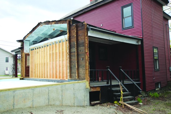

After gutting the home’s one-story connector and sealing the framing with primer, the crew poured a new garage foundation.

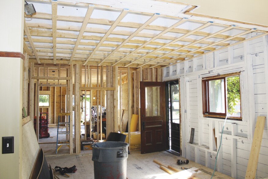

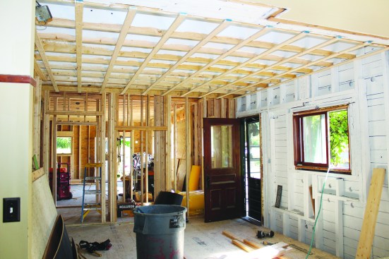

The existing ceiling and hardwood floors were removed in the connector’s kitchen area. Wall, ceiling, and roof framing was primed and left “open” for three months to air out.

Wearing respirators and heavy-duty gloves and clothing, our crew gutted the one-story connector, bagging up the existing insulation and any painted materials. An excavator made quick work of the charred remains of the barn, compacting it into multiple dumpsters in one morning. We then masked off the upper two floors and removed the existing plaster, lath, and insulation from the walls adjacent to the carriage barn, all the while continuously running the air scrubber. The demo work was completed within a week.

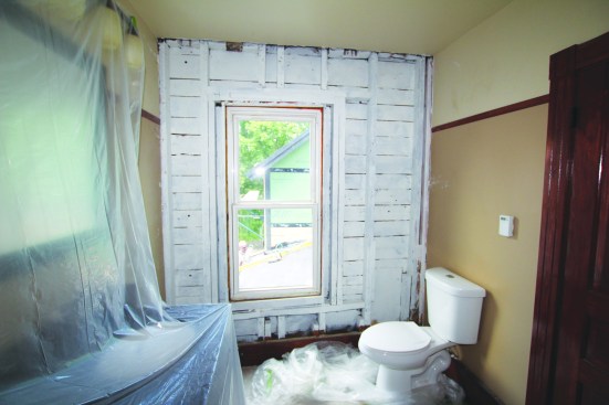

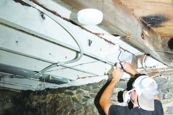

In the main house, plaster, lath, and insulation from the walls facing the fire-damaged barn were removed. Here, the existing framing is primed in a second-story bathroom.
Smoke mitigation. Priming the existing framing was pretty much the extent of our smoke-mitigation work. We left it open as long as possible to air it out, periodically sniff-testing the sealed framing at various temperatures and humidity levels. We primed the worst smoke-damaged areas with three coats of Bin Advanced Synthetic Shellac Sealer and spot-primed where we smelled hints of smoke. We then drywalled at the end of summer.

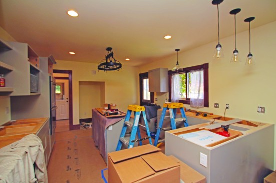

Cabinets are being installed in the new kitchen
Finishing up. After the drywall installation, finishing up the home was standard. We installed a new kitchen and bath in the salvaged connector, closed up the main home’s walls with drywall and Roxul batt insulation, and built the new garage with generous second-story storage. A new mudroom, pantry, and stairwell extended into the footprint of the garage, similar to home’s original floor plan. We also installed a one-hour firewall between the living space and unheated garage.
