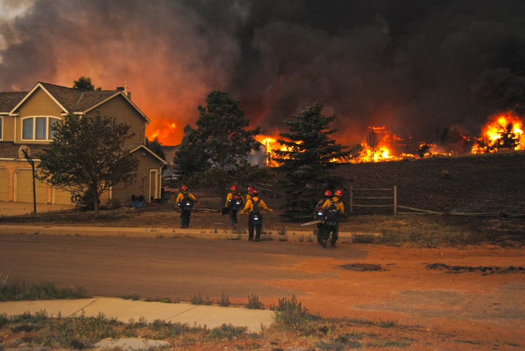

When the Waldo Canyon wildfire roared into Colorado Springs in 2012, destroying a record 346 dwellings in a matter of hours, it was a disaster. But it wasn’t exactly a surprise—at least, not to Colorado Springs Fire Marshal Brett Lacey.

In a big wildfire, strong winds may carry hot embers or even large flaming firebrands for long distances. Embers can be sucked into soffit vents or land in gutters, where accumulated pine needles or leaves may catch fire. The detail above reduces these risks; the soffit and fascia are noncombustible fiber cement, the roof is concrete tile, and metal flashing laps down into the metal gutter. The rough bottom surface of the tile allows moisture to weep out, but restricts the entry of flame and embers.

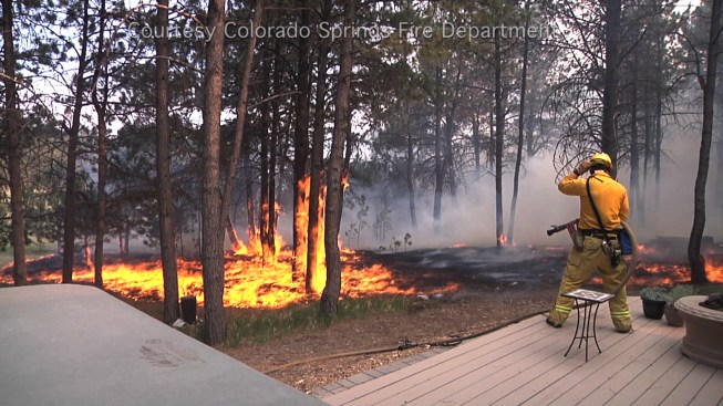

New housing developments in the Colorado Springs wildland-urban interface (WUI) zone must feature “defensible space”—with sparse, pruned vegetation—to prevent the rapid spread of fire.

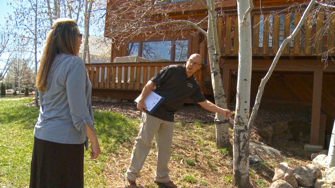

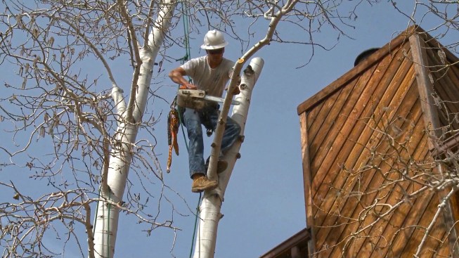

In existing neighborhoods, the fire service is advising homeowners to maintain their properties in a similar way. Arborist Jason Sharp educates a property owner about her choices.
Colorado Springs Fire Department

Appendix K defines a “safety zone” of 30 feet around each home, where fire-prone local shrub and tree species are allowed only in small “patches or clusters,” separated by mown grass or noncombustible materials such as gravel. Trees and shrubs aren’t allowed at all within 15 feet of the house. Some large trees are allowed, but branches have to be trimmed back, away from roofs. These rules reflect the “lean and green” principle: Vegetation is kept thinned and pruned, and “ladder fuels” such as dead lower limbs that could let a ground fire climb up to the crown of a wooded area are removed.

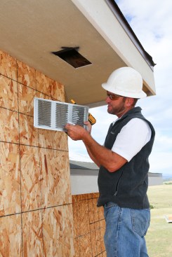

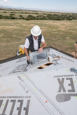

Colorado Springs builder Andy Stauffer installs a screened vent in the soffit of a home near the city.
Stauffer and Sons Inc.
An outlet vent is placed in the home's roof.

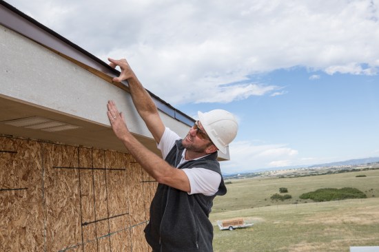

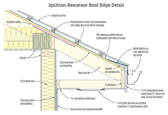

Attic vents. Roof vents have to be screened with wire mesh or hardware cloth, with openings no larger than 1/8 inch. The 1/8-inch opening size is typical of all the well-known wildland-urban interface codes. According to wildfire expert Steven Quarles, who helped craft California’s wildfire code before joining the Insurance Institute for Building and Home Safety (IBHS), an insurance industry think tank, 1/8 inch is a compromise. While the mesh may let small sparks through, it will hold out the bigger embers that carry the most heat. At the same time, the holes are big enough that they’re less likely than finer mesh to become plugged with paint or dirt over many years in service.
Eaves and soffits. Soffits and fascia should be built with ignition-resistant material such as fiber cement or metal. Decorative features like false rafter tails are allowed to be made of wood or other combustible materials, but the fire service strongly urges builders to choose ignition-resistant options whenever possible.

Gutters. The big risk posed by gutters isn’t the gutters themselves, but the flammable materials, such as leaves and pine needles, that accumulate in them and that can readily catch fire when windblown embers land there. When that happens, vinyl gutters typically melt and fall off, posing a risk of ignition at the base of the house. Metal gutters stay in place, which allows burning debris to ignite the exposed edges of roof sheathing.
Appendix K doesn’t require debris screens over gutters, but the fire service cautions homeowners that gutters should be kept clear of combustible materials. Appendix K does require roof sheathing and framing to be protected against ignition by metal flashing at the roof’s edge that extends down into the gutter. In the case of vinyl gutters, the rule requires noncombustible ground covering, such as stone, at the base of the wall where flaming gutters might fall.

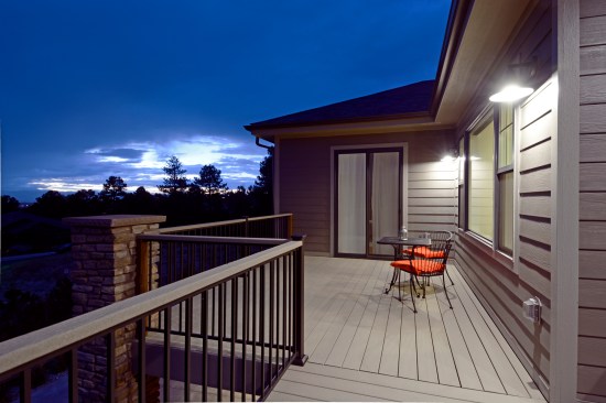

Decks. Brush and trees near a deck can readily set it on fire, as can combustible material such as firewood stored under a deck. Windblown embers can also ignite a deck, but in the Waldo Canyon fire and other fires, composite decking proved less likely to ignite than wood decking, which tends to split and crack and catch hot embers. Appendix K requires ignition-resistant or noncombustible material for decking, but allows wood framing for the deck structure.

The raised deck is framed with treated wood and decked with composite decking.

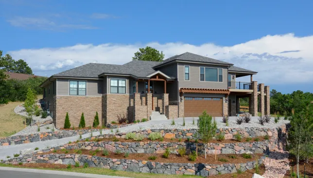

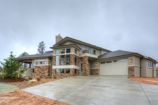

The homes have cultured stone and fiber-cement cladding systems and are set in sparsely planted landscapes with stone mulch.

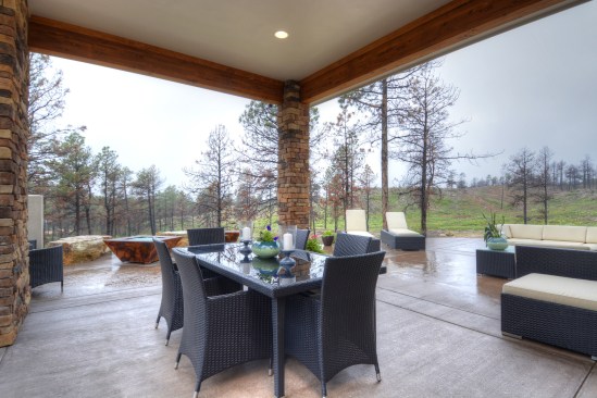

THE INDUSTRY ADJUSTS
The 2012 Waldo Canyon fire set off a minor building boom in Colorado Springs. Local builder Andy Stauffer (staufferandsons.com) rebuilt 11 houses there after that fire, and 10 after the Black Forest fire. But post-fire building code changes haven’t affected Stauffer’s methods much, if at all.
“What I could build after the fire is about what I was building before the fire,” Stauffer told JLC. Virtually every house still gets a synthetic stone and stucco exterior, with fiber cement for lap siding details, soffits, and fascia. Durability and maintenance concerns motivate that choice, said Stauffer: “Clients say, ‘Am I going to be up on a ladder painting this in five years?’”
By the same token, Class A fiberglass shingle roofs stand up better than wood shakes to Colorado’s legendary hailstorms; better yet is concrete tile, which is easier to repair as well as more durable. And in the wake of the fire, said Stauffer, local lumberyards quickly began to stock soffit and roof vents with pre-installed protective metal hardware cloth.
“It was a combination of the clients wanting low maintenance, and the fire departments making reasonable suggestions that the market just picked right up on,” said Stauffer. “People had their own reasons to do what the fire department was asking.”
