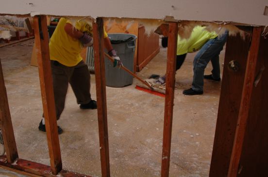

I visited a site that was undergoing the second stage of cleanup. After the pumping and mucking out of a flooded basement, wet and contaminated building materials must be removed quickly both to reduce the habitat for mold and to remove the residual moisture in a building.

Soaked carpet and padding should be the first thing to go. Cut it into strips a few feet wide, roll up as much as you can handle, and crosscut the strip. For carrying these dripping wet materials upstairs and through finished living space, cut rolls only as big as you can put in a bucket or garbage can to reduce the mess. For hard flooring, common sense will dictate what should be removed. If sewage was present in the floodwater, it is probably safer and easier to remove most flooring and start fresh rather than to clean in place. For “clean” floodwater, it depends more on the water damage. Vinyl flooring might be just fine, but of course hardwood floors won’t be worth trying to salvage.

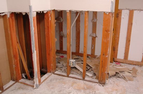

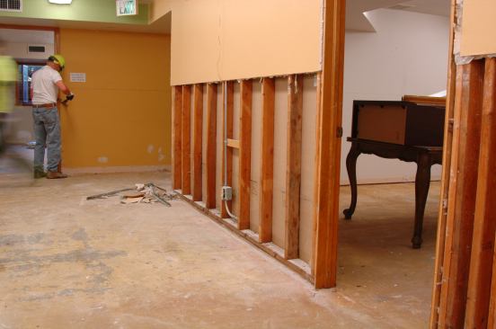

Drywall

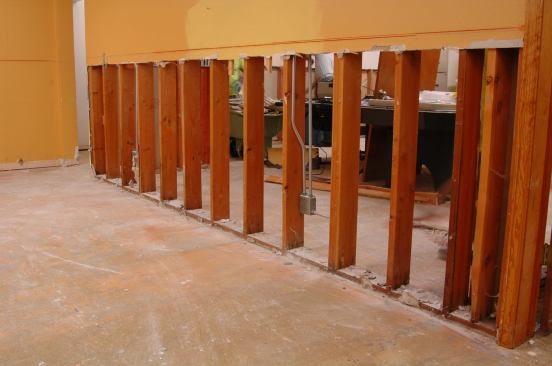

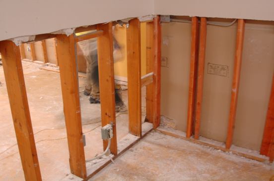

Drywall needs to be torn out at a level at least several inches above the height of the floodwater. For shallow flooding, some people skimp here and only remove a foot or so, but that means patching and finishing work will all have to take place with workers on their knees. This approach seems a bit short-sighted and will probably add labor expense in the name of saving some money on drywall. The professional approach (for flooding under 4 feet deep) is to deeply score the existing drywall 48 inches above its bottom with a utility knife and pry it off the wall from the bottom up.

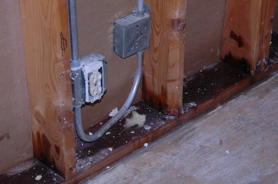

Wood

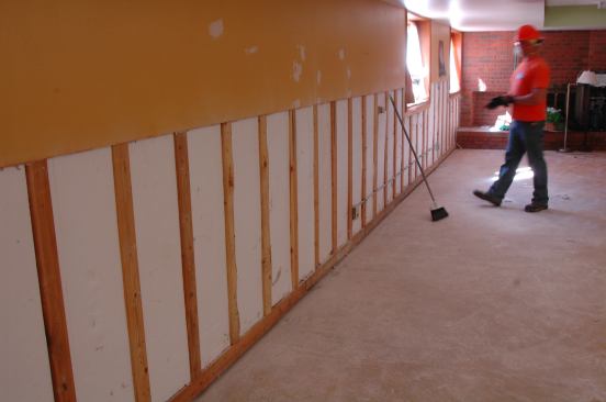

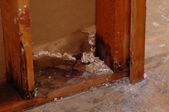

Studs and furring strips are often left in place to dry out. As long as the wood is sound and dry, it should be okay. Any wood in direct contact with concrete (such as furring strips and floor plates) will hold moisture for a long time and should be treated with an appropriate chemical treatment to dry and disinfect it. The use of a moisture meter is important for determining when the wood is dry enough to re-cover with drywall. (More on treating and drying wet wood in my next report.)

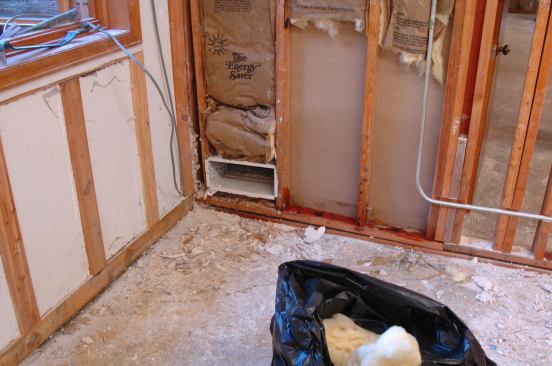

Insulation
Fiberglass insulation that has been soaked should be cut out a discarded. Less porous foam insulation is often left in place to dry out, but not in all cases. Closed cell and open cell foams offer no food for mold to thrive on, but make sure any wood the foam is in direct contact with is dried and treated since the foam can hold the moisture in for a long time. For the same reason, concrete walls behind foam insulation should be given enough time to dry thoroughly before drywall is put back on over the insulation. in most cases, this will require removing the foam, then replacing it after the concrete has had time to dry.

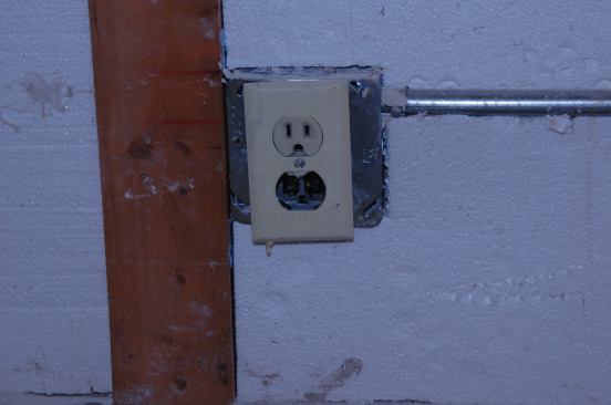

Electrical Wiring

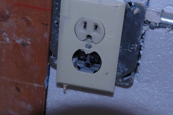

According to the Habitat for Humanity foreman, Romex-type non-metallic cable and plastic boxes should be okay to leave in place, but don’t trust any electrical device that has been underwater. Flooded receptacles and switches should be replaced. Even if they dry out completely, sediment and other fine debris from the flood water could have washed into a device and lead to insufficient contact or shorting.

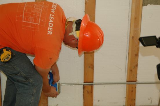

Conduit and armored cable can hold water inside and present a greater danger. Do not use these circuits without inspecting for soaked wiring and consulting an electrician for help.
While I was at the Habitat site, a volunteer using a shop vacuum illustrated the seriousness of this danger pretty effectively, and got a good scare in the process. After running the vac for a minute or so plugged into a receptacle wired through conduit, the device exploded with a flash that lit up the room like lightning. The plastic face of the receptacle was incinerated, leaving bare metal contacts visible. I’m not sure if it shorted out due to water in the device or conduit or what, but it made the point clear.
HVAC Ducts
Ducts that were underwater should be dismantled and cleaned out or replaced.
And don’t forget to clean out the bottom of the furnace cabinet and dry it out. If water made it up to the blower or pump motor, it may be ruined, but get a professional opinion on the state of the furnace and hot water heater.
